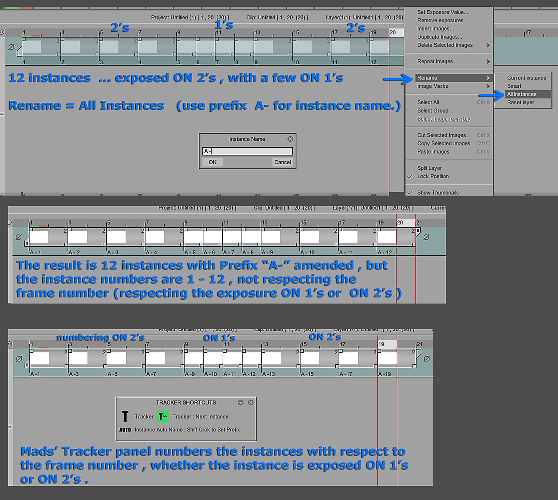

Is the feature mentioned anywhere in the User Guide or any of the video tutorials ? I'm not sure how the new user would know about this feature ?
However, the reason I still use Mads' Tracker panel is because with TVPaint's default Rename > All Instances I can amend a prefix (and/or suffix) to the instances , but the numbering of the instances is according to how many instances there are , not according to the exposure of the instances on the timeline , where they are positioned at the frame number . So 12 instances (some exposed ON 1's and some exposed ON 2's) get a prefix (A - ) amended in front of the number ,but they are numbered as 1, 2, 3, 4, 5, 6, 7, 8, 9, 10, 11, 12 , not respecting the exposure and the frame number .
With Mads' Tracker it respects the exposure and the frame number , so instances ON 2's are numbered 1 , 3 , 5 , 7 , 9 , etc. and instances ON 1's are 10,11,12,13,14 , etc.
[click image to view larger]
Mads' Tracker panel understands that the animator wants to keep the instances numbered according to the frame number as in the classic system for numbering .
I think this would be better for the default Rename function in TVPaint to behave like Mads' Tracker when renaming instances .

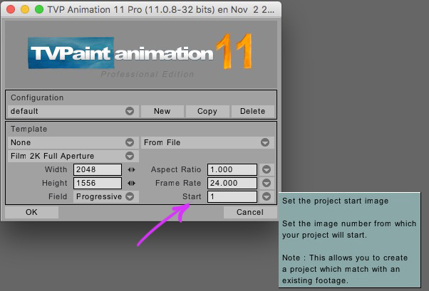

Also, it numbers the first instance "0" which can't be used in other softwares,
I'm not sure what you are talking about when you write: "It numbers the first instance "0" ... what is "it" ? Do you mean the Tracker Shortcuts panel I recommended ? If that's what you are referring to , then I am not sure how you're getting the first instance to be named as "0" , unless your scene is set with a Start Frame of 0. You can change the start frame to 1 in the Start Up Panel when you create a new scene or click on the Start Frame button at the lower left of the interface.
Start Frame.jpg (95.03 KiB) Viewed 27026 times
I'm uncertain if you are using TVPaint 11 or TVPaint 10 ? The screen shot you included in an earlier post shows TVPaint 10, but in another place you mentioned being able to use the Japanese Timesheet script (which is TVPaint 11 , only) . In the case of TVPaint 10 , there is a little custom panel called Start Frame , which you can install. (I would then copy and paste the 0 and 1 buttons to the Misc tab on the Animator Panel )
You can get the Start Frame custom panel here:
https://www.tvpaint.com/forum/viewtopic ... 431#p34421
Start Frame 0 or 1 .jpg (78.78 KiB) Viewed 27017 times

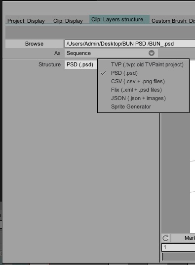

You can also export to .PSD with Clips Layer Structure > .PSD (Sequence) , but again ,the bad news is that it does not retain the instance names from the timeline , it renumbers them as 0000.psd , 0001.psd, 0002.psd, 0003.psd , 0004.psd
Screen Shot 2018-02-08 at 1.48.03 PM.jpg (31.12 KiB) Viewed 27000 times
