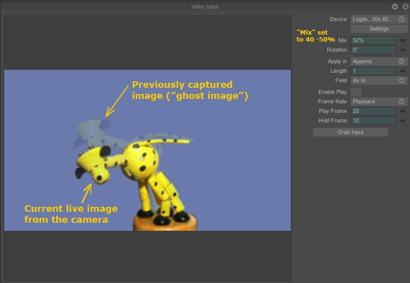

To grab video footage, you must first ensure your peripheral device (webcam with USB, or mini-dv firewire camera) is correctly installed. Then, you must right-click on the webcam icon button located on the bottom right-hand side of the project window or go to the menu Windows > Animation > Video In Settings. This action opens the Video Input panel. ]
If your device is correctly connected to your computer, opening this window will show what is presently seen by the device in the preview window. You may need to first select your device as from the menu of available video input devices (this list will vary depending on how many video devices you have available . If you only have a single webcam enabled then that is the only device you will see).
Here is a view of the Video Input panel with the list of available video input devices. In this example the Logitech Webcam C930e 2 will be selected.
The Video Input panel settings:
* Device : you choose here which video input source you will use (very useful if you have several cameras or webcams connected ). The “Settings” button, just below will open the webcam’s settings if you are using TVPaint Standard Edition (32bits version) . In TVPaint Pro (64bits) this Settings button is not used.
* Mix : the mix option is a little like a light table or “onion-skin” function (very useful if you make stop-motion movies). This option will allow you to see the previously captured image superimposed with the current live image from the webcam, to assist you in accurately gauging the spacing of the object or puppet you are animating .
* Rotation : rotate the orientation of the captured image from 0°, 90°, 180° or 270°. (very useful if you want to use the video input to line-test an animation made on paper. Instead of turning your camera, rotate the image orientation with TVPaint .)

*Grab Input - this button will grab video input from the camera. You may also use the keyboard shortcut Tab to execute the command to grab video input.
