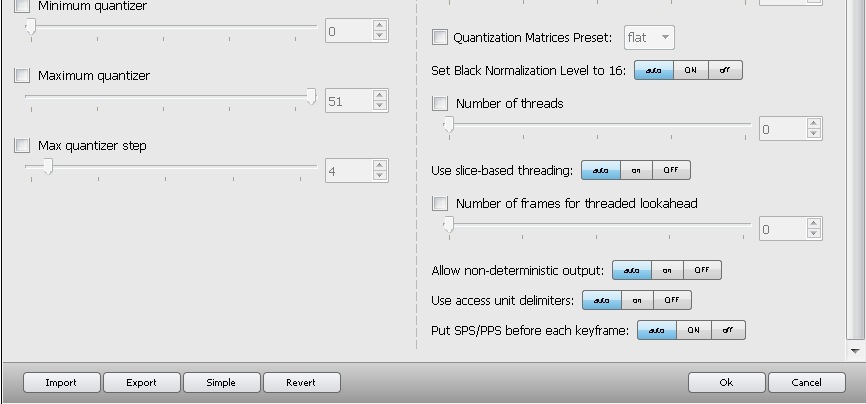

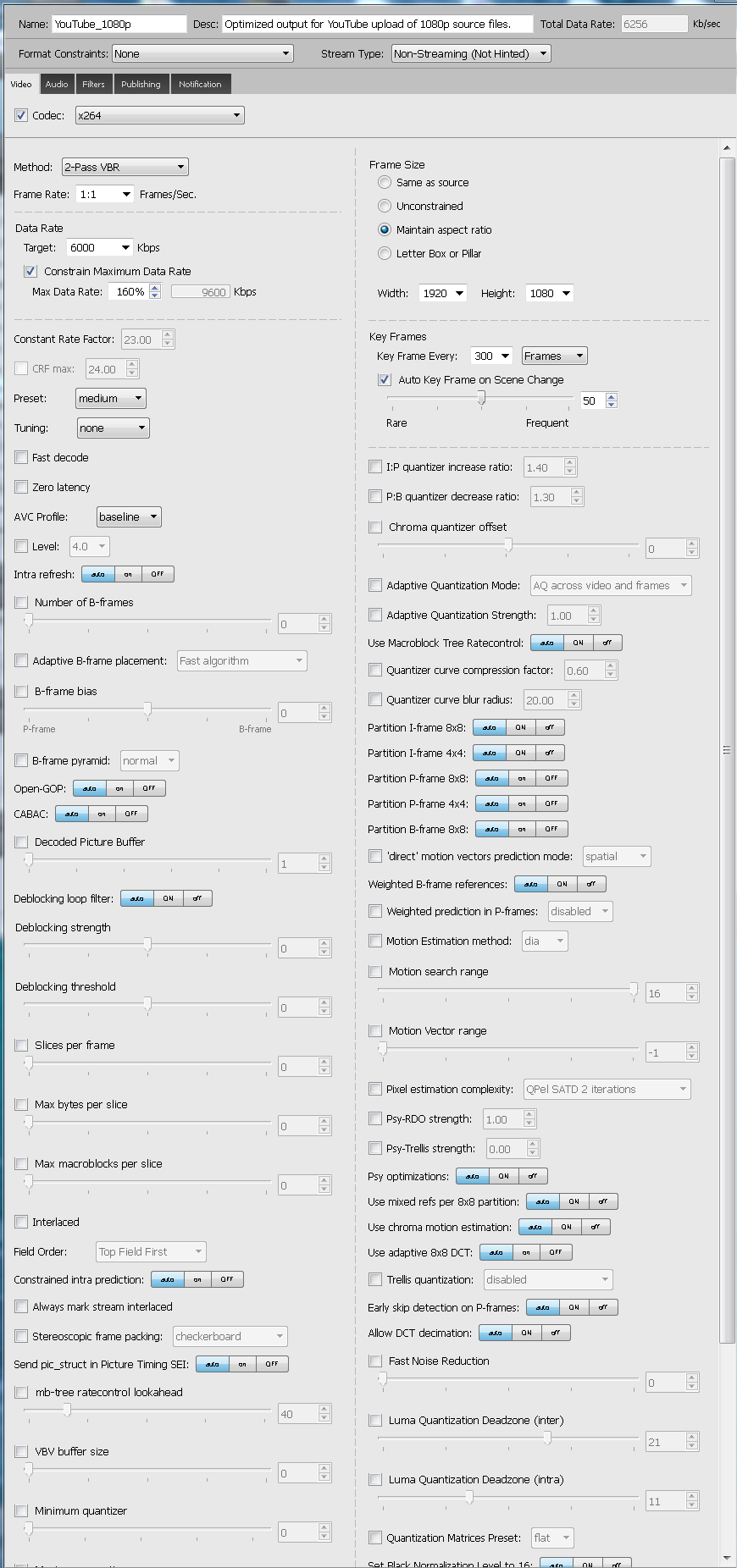

None of the types of video you mention 2 posts above will work on TVP 10.5.7 in 32 or 64 bit on either of my machines.
I've been using Sorenson's default settings for Youtube output, which are shown in the below 2 images. It shows the many settings available for Sorenson's output. Not shown in the screengrabs are the available flyout options for "Codec" and "Method". They are..
Codec Flyout Options: x264, Sorenson MPEG4Pro, Sorenson H.264, Apple H.264, Main Concept H.264. Main Concept CUDA H.264
Method Flyout Options: 1 Pass VBR, 2 Pass VBR, 1 Pass CBR, 2 Pass CBR, 1 Pass CQ, Multipass, (Not all "Method" optoins are available for each Codec.)
Maybe I need to install additional 264 codecs.

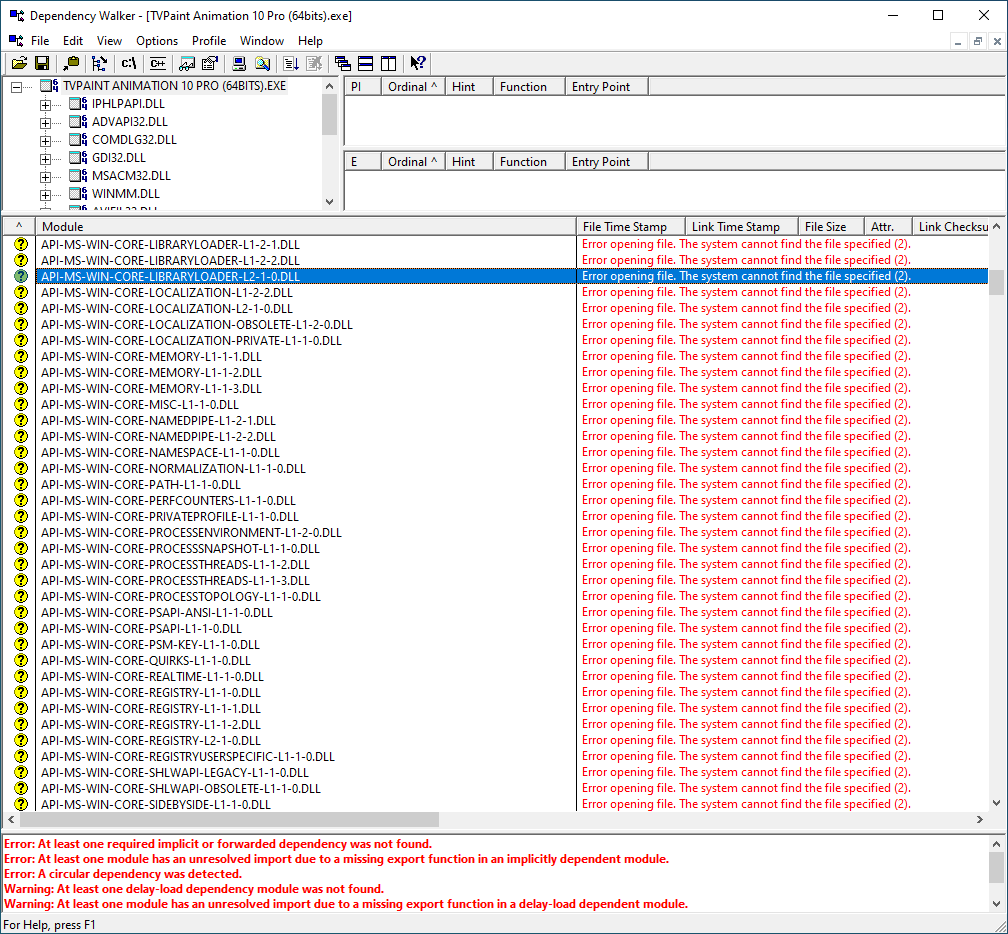

EDIT: I had a Win10 VM, so I tried installing TVPaint 10.5.7. You're right, the videos cannot be imported. Some dependencies are missing :
According to this thread, it's simply that the MS API evolved:
https://social.msdn.microsoft.com/Forum ... ncore-dlls
Which means basically that TVPaint 10 is not compatible with the new Windows versions.
Sorry, please upgrade to v11. Or else try on MacOS / Linux.
