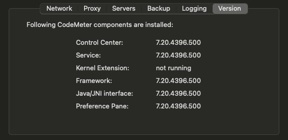

I took a look at a 3rd computer that also works fine with codemeter licence stuff and the numbers in the CmContainer are different on that device to the other two.. could it be a problem of the container having the same identifier as the previous computer? (The way i've set up the system was through a time machine back-up). i have used the codemeter remover also and this doesn't seem to change the numbers if that's even a problem or not haha.
Also here is what's going on within system preferences.
Screenshot 2022-07-01 at 14.44.15.jpg (31.3 KiB) Viewed 72049 times
UPDATE:
It's working now! I deleted the codemeter folder from the /library and re-installed again, that did the trick! Thank you for the help and quick replies Dean !!
