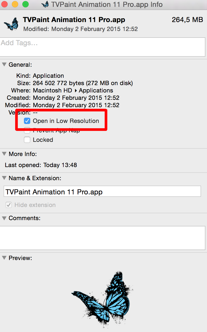

Re: Mac OS X 10.10 Yosemite and TVPaint Animation
A little thing. Have you checked this ?
skomdra
Posts: 146
Joined: 14 Aug 2010, 14:32
Post by skomdra »
yes, no lagging in tvp when I start in lo res on 11! :) so that was it. But on 10.5 is still lagging. It is comforting thou that at least the new version will not lag. Thanks Elodie.

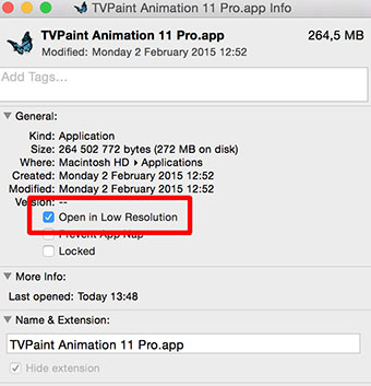

Elodie wrote: A little thing. Have you checked this ?
skomdra wrote:yes, no lagging in tvp when I start in lo res on 11! :) So that was it.
A question: how would someone who does not frequent this forum know to do this ? (start TVP 11 in low-res. on Yosemite ) . It is not mentioned in the FAQs or in the User Manual.
Open TVP 11 in low-def.jpg (56.91 KiB) Viewed 36247 times
Posts: 2821
Hmm, you're right, it should be mentionned at least in the FAQ, we'll add it.
It was not in FaQ because this problem concerns only Mac with retina screens (and until now, very few people gort such expensive computers), so the problem was not fréquent (i've maybe answered this problem 3 times since the release of the first retina mac book pro).

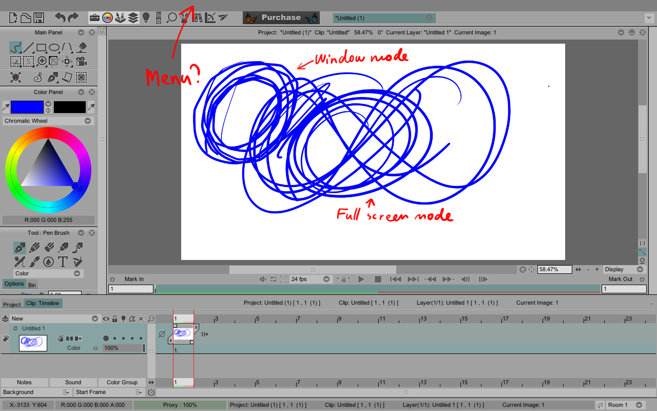

Not sure if to post it here, or in a separate topic.
I am trying out TVP 11 on Yosemite now. And ... frankly - I'm completely baffled and quite upset:
1. The line lag issue, that was discussed here already - OK, it works fine, when TVPaint is in Full Screen mode. But, does it mean, that in Window mode it will not be functional? What about the Standard version - does it have the Full Screen mode in TVP 11? Because in 10 it doesn't...
Also - I don't see "Open in Low Resolution" in the properties. what I see instead is "Open in 32-bit mode". when I try it - nothing changes...
2. The upper menu disappears behind a gray bar - clicking on it reveals the menu, but after switching apps it disappears again. looks like a bug (check the screen-shot)
3. And now to the worst of it - I tried also 32-bit version, and well - it crashes on start. It just doesn't start. Does it mean that there is no working Standard version of TVP 11 for Yosemite?
Just for clarity - TVP 10 standard works perfect.
Screen Shot 2015-07-03 at 11.31.43 (2).png (226.7 KiB) Viewed 35890 times

Posts: 2821
Soom wrote:Not sure if to post it here, or in a separate topic.
The "Open in Low Resolution" only appears with Retina displays. Do you have one ?
That is a known bug, and we're working on it. However this probably won't be fixed for next build.
Just because it doesn't work for you doesn't mean that everyone has the same problem.
It may be because of your config. Did you copy-pasted your config from v10 to v11 ?
Could you try to delete your config (located in /Users/<username>/Library/tvp animation 11) and try to launch TVPaint Animation again ?
