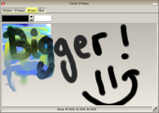

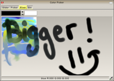

Color picker didn't change, but the mixer tab can be now in the size you want =D

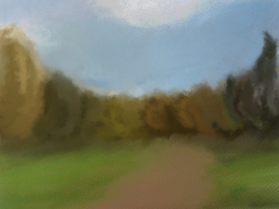

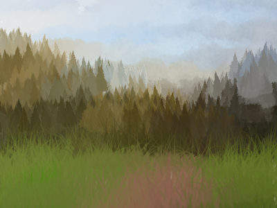

As we are talking about drawing tools, I take the liberty to show you the new custom brush feature, "Smear source".
Smear source needs a source that you can define in the Shape settings panel. Smear source allows you to smear the source (spare, layer, previous image...) you defined with the A color. This option is really great for people who want to make “painted rotoscopy”.
In the following examples, I used a forest photography and different custom brushes from the new Tool bin :
Re: TVPAINT ANIMATION 10 : Pre-order now !
in addition : the smear source allows to have those changes (from photo to the final painting) on an other layer ! So it's not destructive.
