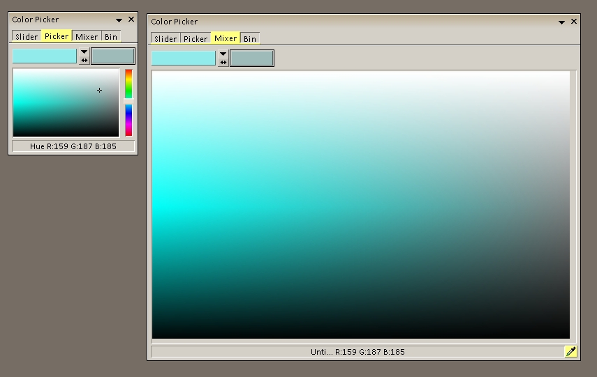

Joost wrote:Hello,
Does TVPaint 10 have a better way to use the color picker?
If you compare tvpaint 9.5 with Photoshop: It is much easier to pick a color in Photoshop because the color pick screen is more than twice the size of the tvpaint color pick screen.
Also in photoshop white is in the upper left corner, bright colors in the upper right corner, black colors on the bottom. In tvpaint it is different and therefore more difficult to choose the right color. Most of the times I use Photoshop to choose a color in stead of tvpaint.
Hoi Joost!
no, no... TVP's colorpicker is much bigger!
:wink:
in de mixer kun je elk plaatje zetten dus ook je custom kleurmodelen.
als je zorgt dat het pipetje staat aangevinkt is het "one click" color picken
Peter, how did you get the window that big? Dragging the corners doesn't work for me.
Re: TVPAINT ANIMATION 10 : Pre-order now !
Peter was joking : the color picker tab can't be bigger, but the color mixer can (see one of my posts, on the previous page), in TVPaint 10.
But, I must say, I don't know how peter has done to put a color picker gradient in its mixer O_o
Did I miss something ? Or did you make a "montage" :mrgreen:

Elodie wrote: But, I must say, I don't know how peter has done to put a color picker gradient in its mixer O_o
screen capture ?
The fake is confirmed, it was a joke (which will bring maybe a "last minute" new feature :wink: )

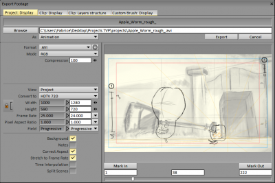

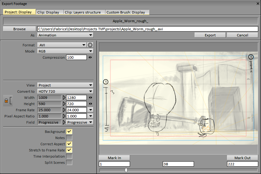

But let's go back to TVPaint Animation 10.
Here is an other screen capture : the new Export Panel, much more friendly :)
Posts: 4526
Elodie wrote:
i am off course never joking:
-hold the colorpanel by its topbar press G
-Z scale the brush up
-put it down
- pick the gradient up as a custombrush
-export brush as imag
-RMB in colormixer> File > import the exported image as your mixer
ready
admittedly not the most practical but also not fake.
Sewie
Posts: 1310
Joined: 18 Jun 2008, 11:57
Post by Sewie »
So the trick is to first turn the panel into a custombrush. Though smart, it's not very practical.
Wouldn't a feature request for a scale-able colorpanel be better?
Peter Wassink wrote:-hold the colorpanel by its topbar press G
-put it down
ready
Ooookay, for sure, it's not the most practical. I didn't think about save the color panel as an image and reloaded it into the Mixer. Not bad !
But I think that adding a real feature would be better, hehe :mrgreen:
