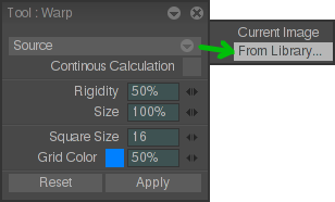

schwarzgrau wrote:Could you explain this any further? I'm not sure if I understand how it works.
You just add any image in the library, then you can use it as source in the warp tool.
In this way, it's eliminating multiframe, generational degradation.
The anchor points becomes persistent too, since it's always the same image.

That's quite nice. But now everytime I apply the transform I get one more copy of my image.

I've taken a deeper look into the new Warp-Tool in combination with the library.
- Setting a picture from the library as source is a very nice feature - would be very cool to have it also for the transform and the perspective tool
- managing the warping is more succesful, when using a full colored picture (full filled with pixel). Using a pure lineart acts strange. The picture seems to break into different solid parts moving around. It's very hard to control.
- I often had the case, that when have moved one part (e.g. a nose of a face) and try to move the next part (e.g. an ear) the nose walks back to it's original position. Again, it seems very hard to control (I've found and tried to use the lock point feature).
- It takes some irritating time (some seconds) after setting a picture for the warp tool to the moment, when I can see the image. (There seems to be some more glitches with the optical feedback: After deleting the frame content, I had to deselect and reselect the warp tool, to not see deleted content.)
- There seems to be no optical feedback for the settings of the warp tool. Specially for the Square Size and for the Rigidity would be any feedback very helpful to get an idea on what will happen, when using the warp.
- Changing the source picture resets the warp tool. Would be a nice possibility to change the pictures while animationg some warps. Think on animation ;-)!
OK, after all: The warp tool is a nice feature. The idea of the library as a source is great and prevents from classical mistakes when manipulating the same picture again and again and wondering about loosing the quality. But, in my opinion, it is on a very good way to be a cool feature. Not more.
schwarzgrau wrote: Fabrice wrote:nb : using the library with the warp tool just avoid the loss of quality when working.
Eric Scholl wrote:
schwarzgrau wrote:that wouldn't be possible in TVPaint, because of the blurring you get with every transformation and I guess that's fine.
You can get rid of the blur by using an Image in the Library as source of the Warp Tool.
I think, it means, that staying with one and the same source picture from the library prevents from the classical mistake I mentioned above, when manipulating in different steps. It's the same technic (Stay with your original drawing!), but much more comfortable and better to control during animation.
