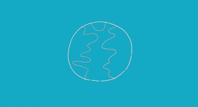

I don't see a way to post two images at once. This first image uses black from the sketch panel.
Janet Perlman
Posts: 66
Joined: 07 Oct 2014, 03:35
Re: Preserving white line
Post by Janet Perlman »
This image is where I erased the black, which leaves a black edge to my white line. If I use other colors, the white line also disappears completely. I see that if I use a simple pen with no texture and a cleaner edge, this does not happen.
