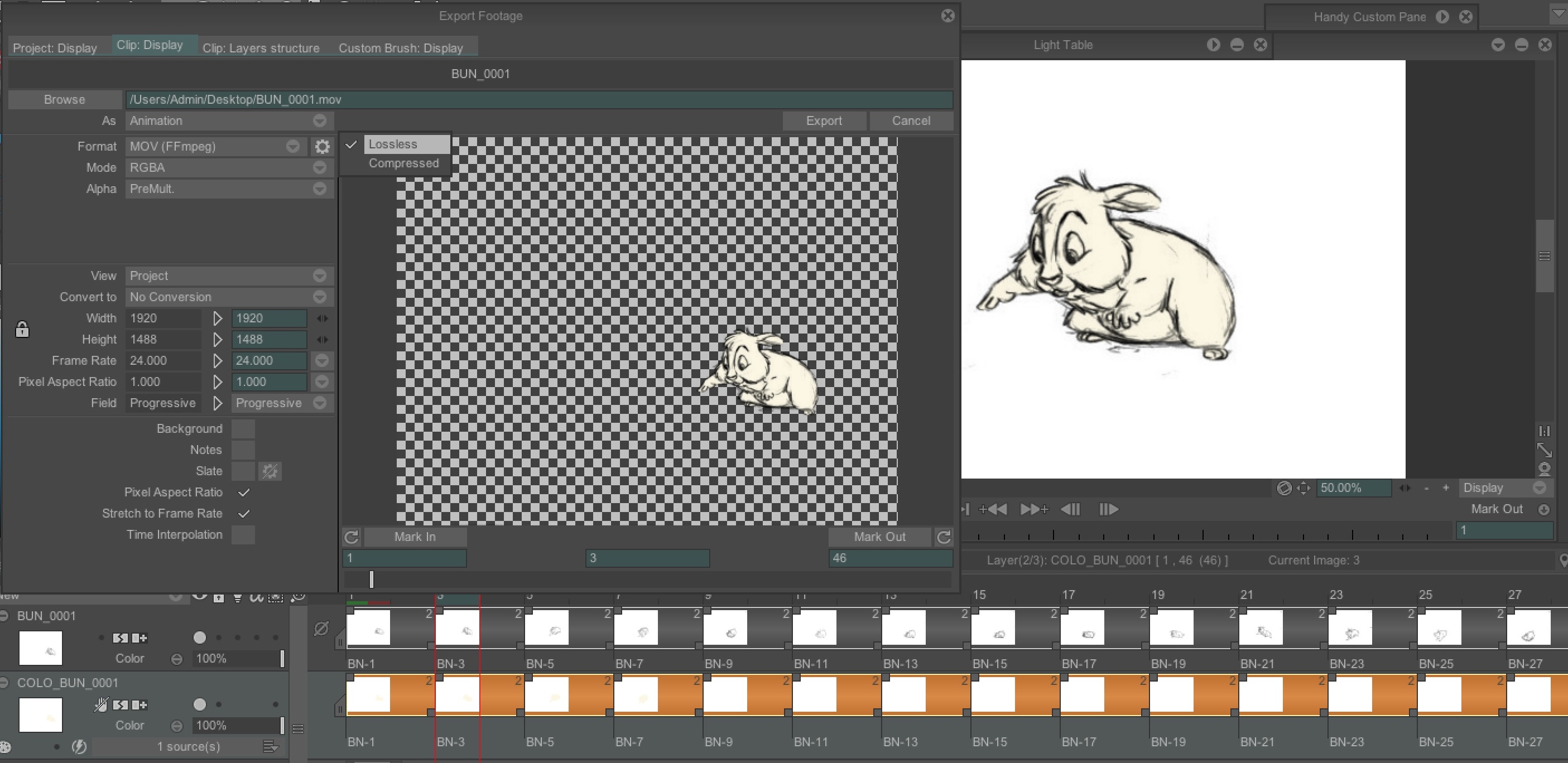

It's not so much that Quicktime isn't a good format , it's that Quicktime is being abandoned by Apple. It's still alive for Apple users in existing applications . I still use my Quicktime 7 Pro almost every day.
Anyway, I just had a conversation about export formats with an editor recently. He needed me to export each layer of a scene as an individual element with transparent background for assembling in editing and compositing with a CG background.
He had expressed a preference for files exported with Apple ProRes 4444 codec, which supports transparency , but that codec is only available if using the 32bit version of TVPaint . I prefer using 64bit for the added speed , but 64bit version only has the AVI export and Export to FFMpeg .MOV in either Lossless (Apple PNG) or Compressed (MPEG-4) . The FFMpeg Lossless (Apple PNG) supports transparency. I ran a test and the editor said that the file exported from TVPaint 64bit with FFMpeg Lossless codec worked fine , as good as the Apple ProRes 4444 exported from TVPaint 32bit.
Settings: FFMpeg MOV , Lossless , RGBA mode , Background UNCHECKED .
(click image to see it larger)
That said ,exporting to a PNG image sequence also yields very good results. For final color images I would lean towards exporting as PNG Image Sequence.
(if you need to support transparent alpha layer in PNG then use the RGBA mode) . PNG image sequence can be imported to Premiere or Final Cut or AfterEffects and no loss of quality.
