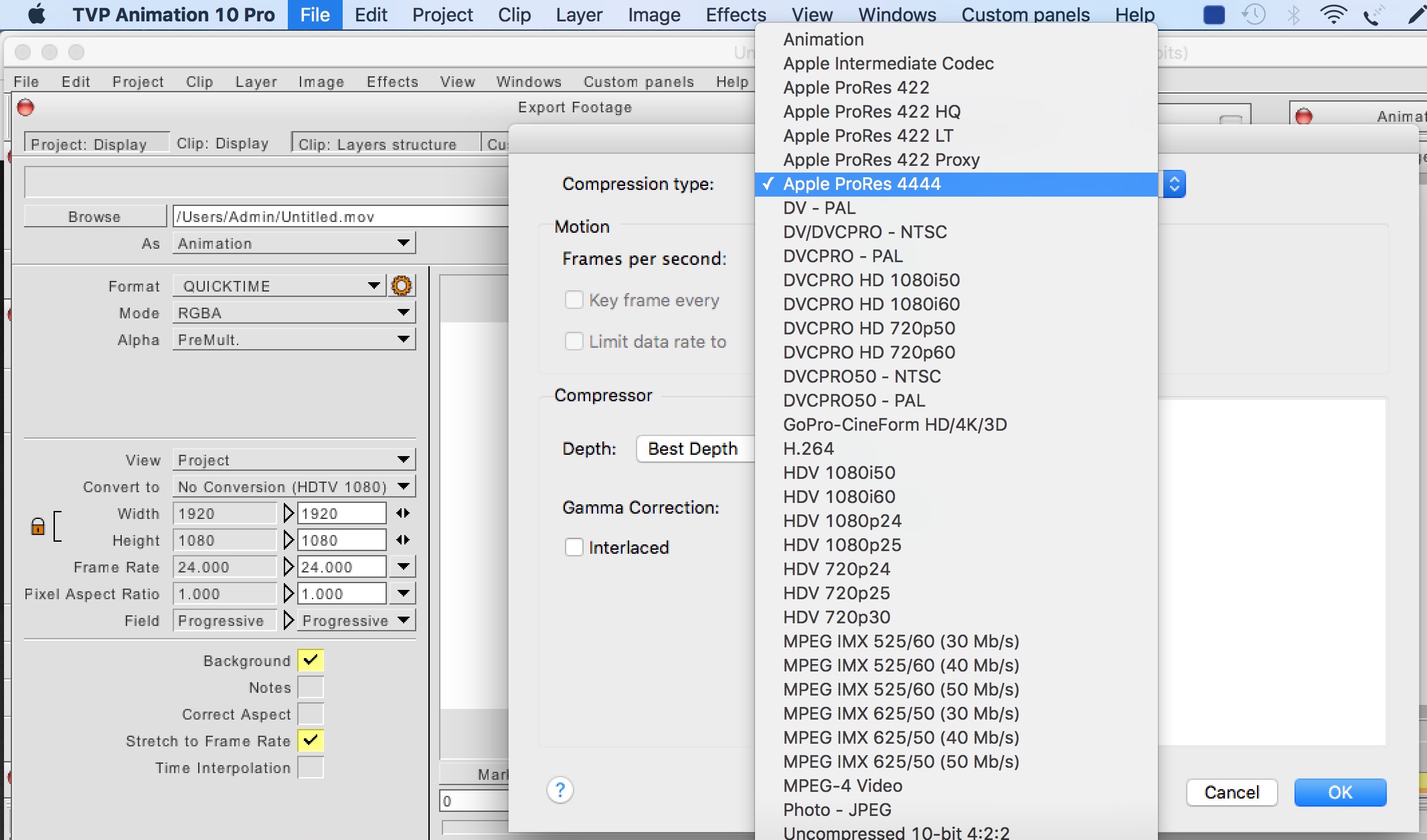

Hi, Thank you for your support. My TV Paint is 10.5.7 (32 bits). Is this effectively version 11? I tried exporting my animation to Quicktime, RGBA but there is no available format to convert to FFmpeg and ProRes codec.
Re: How to Convert Animation to ProRes
Posted: 19 Aug 2016, 13:17
DGreaves wrote:Hi, Thank you for your support. My TV Paint is 10.5.7 (32 bits). Is this effectively version 11? I tried exporting my animation to Quicktime, RGBA but there is no available format to convert to FFmpeg and ProRes codec.
With 10.5.7 32bit TVPaint you can export directly to ProRes (if you have the codec installed).
