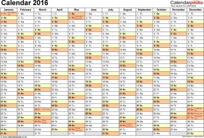

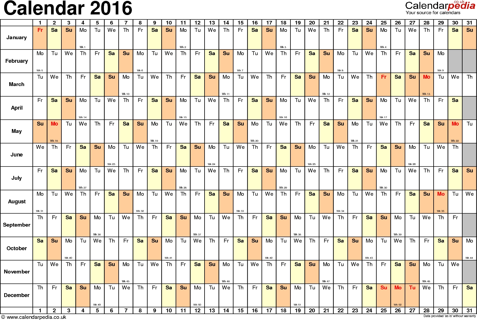

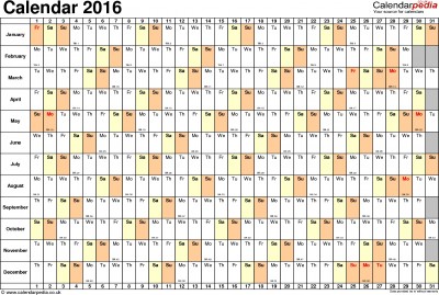

All you can do with the Xsheet can be done in a Timeline. The first one is vertical, the second one is horizontal.
It's like two views of the same calendars :
The concepts behind those views of your animation (instances, exposure, keyframes, etc.) are still the same.
