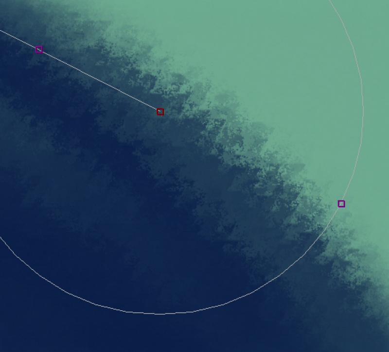

1. Some satured colors appear from time to time (Screenshot below).
I have to precise it's generally appearing when I apply the Brush Spreading on the second time, not first time.

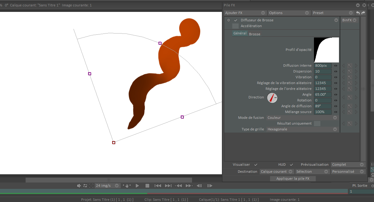

2. Since I've updated my version to 11.0.3, I can apply the Brush in a specific direction, but I now I can't get back to a random angle brush application
I've tried to change all the parameters, unsuccessfully.

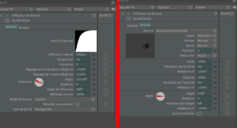

"Directionnal" brush application
"Random" brush application (I managed to do this one by changing my original animated brush, I rotated manually some images)
My current parameters

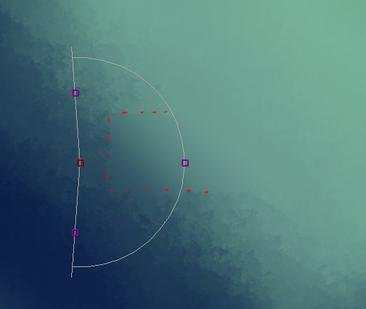

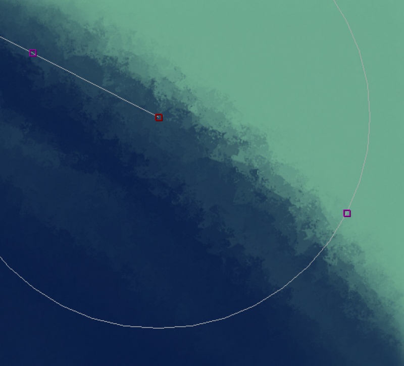

3. When the "diffusion interne" (don't know the english term) is not high enough, the FX applies letting a "square" appearing :
Thanks in advance for your answers :)
This problem is pretty hard to fix as it is not linked to the FX itself but to the way calculations are done with TVPaint, with the processor + the color management, etc.
It will not be fixed in the current engine. But maybe tweaking the settings might more or less fix the issue.
not a bug. just increase the value of the parameter.

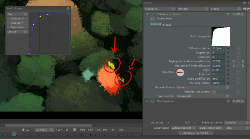

Thanks Fabrice, I see. I asked the question because as I read this thread : http://forum.tvpaint.com/viewtopic.php? ... ing#p87284, I thought it would work differently (with a sort of fade).
Maybe I'm not using the right parameters but I didn't managed to get this result... (There's a link to a video Elodie had made but it's available anymore unfortunately)
Maybe you can see what I'm doing wrong :
indeed, it looks like a bug.
More informations tomorrow.

Mabouh wrote: Thanks Fabrice, I see. I asked the question because as I read this thread : http://forum.tvpaint.com/viewtopic.php? ... ing#p87284, I thought it would work differently (with a sort of fade).
Hello, sorry for the late answer, the school semester is starting and we have less time. I didn't notice it immediately :
Change the spreading angle from 89° to 360°.
if the brush is big and at size = 100% , you can also tweak it's profile.
