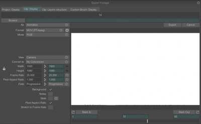

I have a problem when I export a clip.

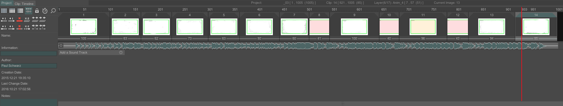

I created a couple of scenes in the project tab and added a soundtrack there.
When I go to the Clip:timeline tab, I can scrub through the scene and hear the sound.
But when I export a clip there is no sound playing.
I tried to export as AVI and MOV but both files have no sound.

Hmmm, actually, the sound is "physically" in the project, not in the clip. You can hear it because the option "play sound from project in clips" is surely enable in your preferences.
However, you can try to split the tracks in project to the clips before exporting a clip.

Yes, that is what I was doing wrong.
I have to split the track to clips.
It works now.
