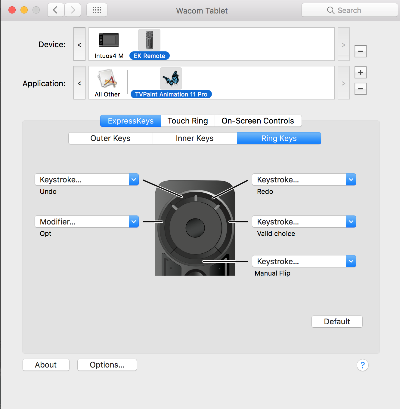

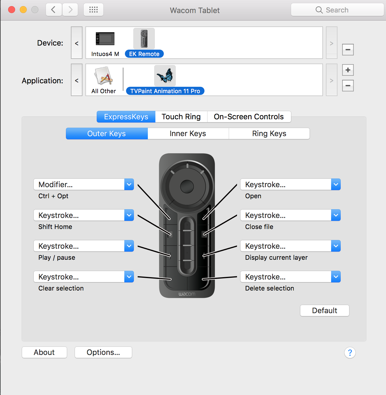

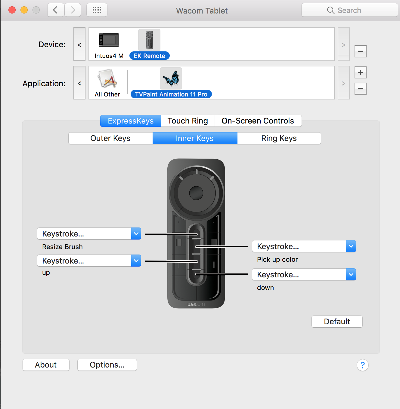

Re: Programming a Cintiq express key remote for TVP?
There you go :
(Only "Manual Flip" must be assigned in TVPaint : it's when you use the Flip panel. By default, I think I used the letter J)
Preferences.wacomprefs.zip
(54.07 KiB) Downloaded 344 times
Unzip the folder and double click on "Preferences.wacomprefs" to install the preferences (a windows will appear : you can close it immediately, for it will just inform you that everything was installed properly).
Nothing is assigned to the Touch Ring because at the time I tested it, it was terribly laggy on Mac. But since, we made a couple of improvements, so you can try to configure it.

I'm not entirely clear on "modifier" buttons and how they're used -- when you click on a key that's programmed as a modifier, does that change all of your express keys to function as something different? Or does it only modify the next key that you press?
-Bruce
Modifiers are keys like Ctrl, Alt and Cmd.
You can have a remote's button configured as Alt only and another button configured as Ctrl, for example.
In my case, I have one button for Alt (to pan and zoom) and another one with Ctrl + Alt (to rotate).
Hopefully it helps.
