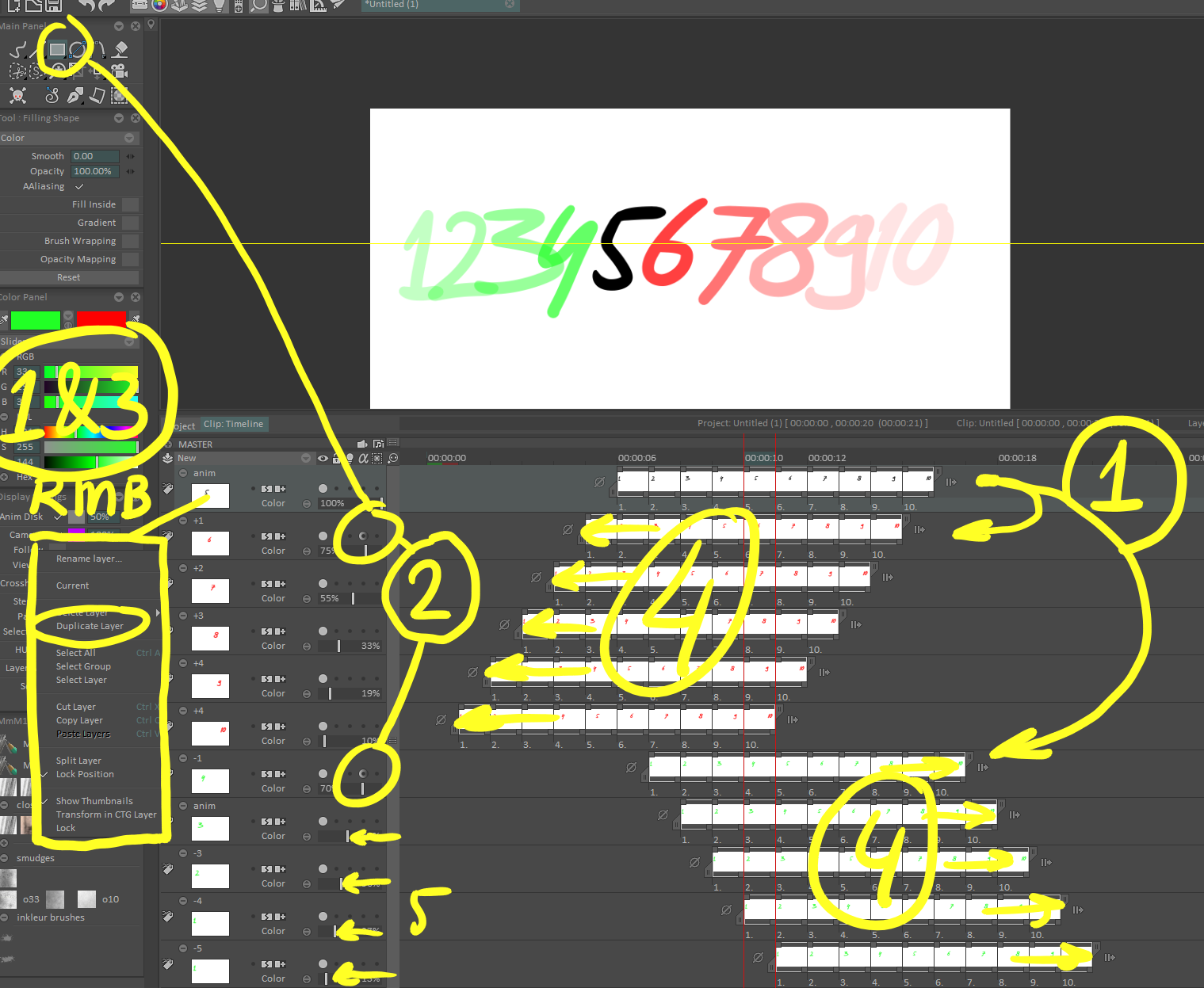

1 duplicate the layer with the animation 2 times ( Right Mouse Button on the layer thumbnail)
2 re-color each of the 2 duplicte layers using alpha lock
3 duplicate each of the re-colored duplicates layers for the number of lightable images you need
4 off set these copied layers on the time line
5 adjust their opacity

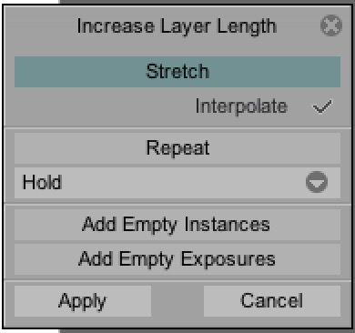

Try Svengali's "Trails" script he uploaded above , but you also might want to try combining it with the Stretch - Interpolation function in Increase Layer Length . You can get some nice effects by splitting certain portions of a layer, then Stretch and apply Interpolation, to get "ghost images" between drawings . It can be tricky to plan the timing precisely, but experiment with it and you might get some interesting results.
