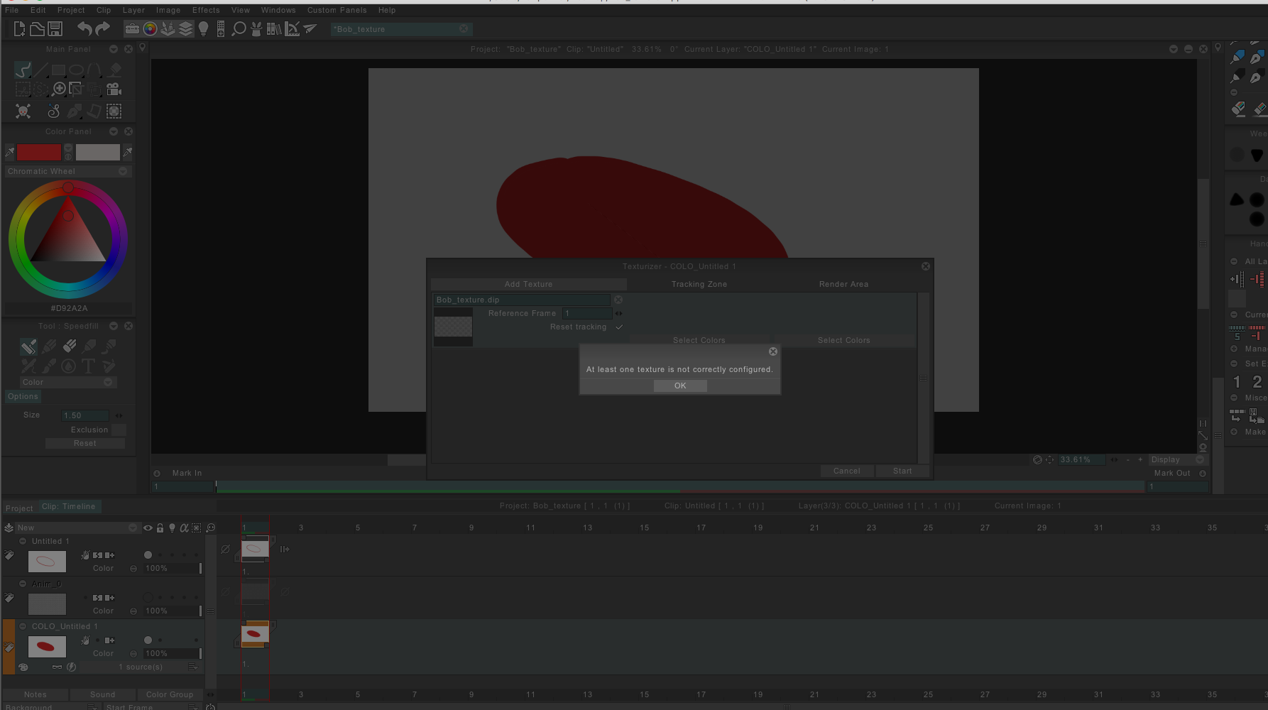

thank you for your reply. I have attached a image of the msg I keep getting whenever I try to import a texture. The Texture is by the way the same size as the project. I don't understand how I should configure my texture file? :S
Thank you in advance for your attention and help!

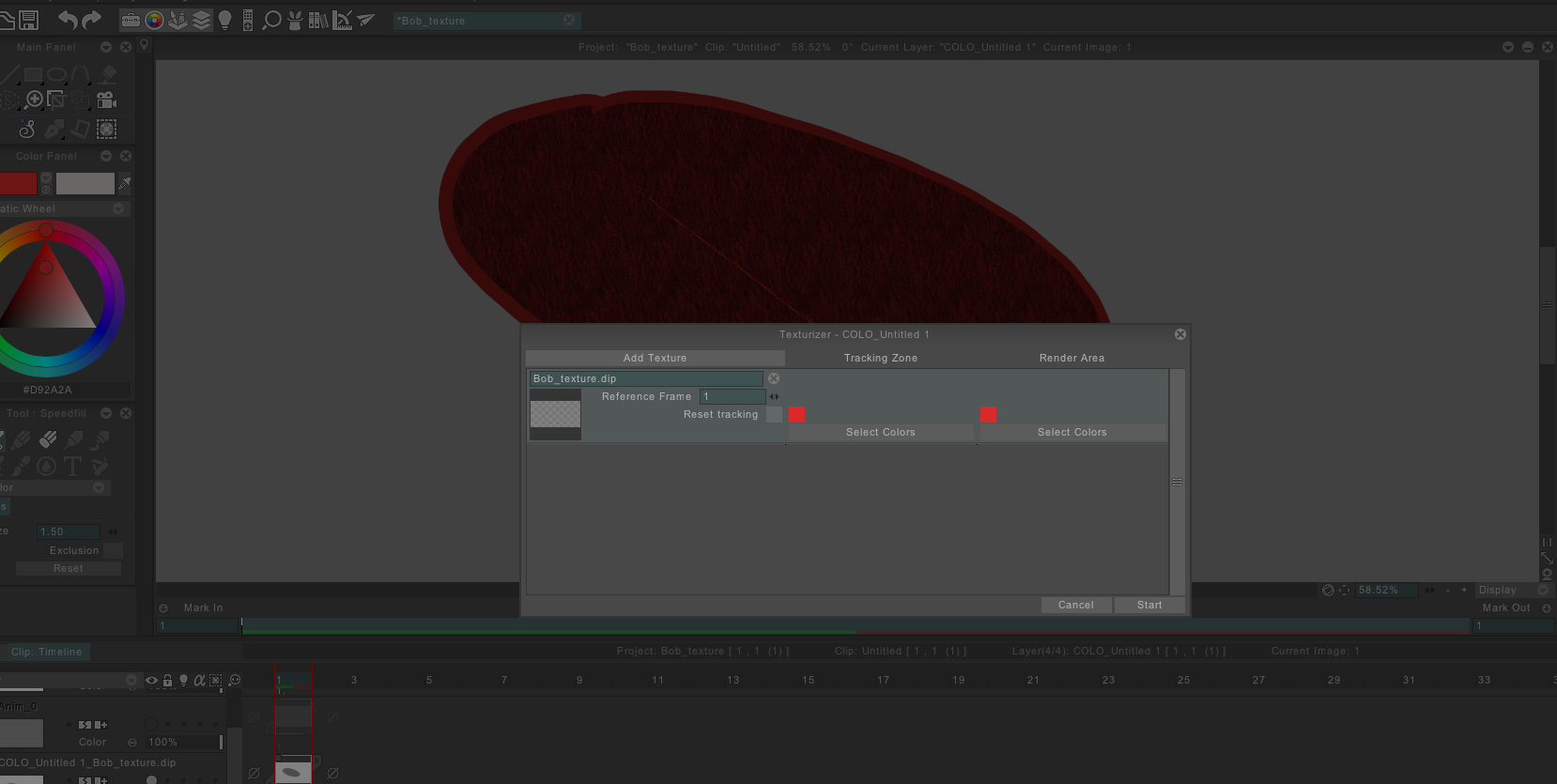

Hello again Fabrice,
Ah I think I have figured it out. I had to choose the colours... (this wasn't mentioned in the tutorials so this is where I got stuck). Thank you again and I shall continue on with the documentation.

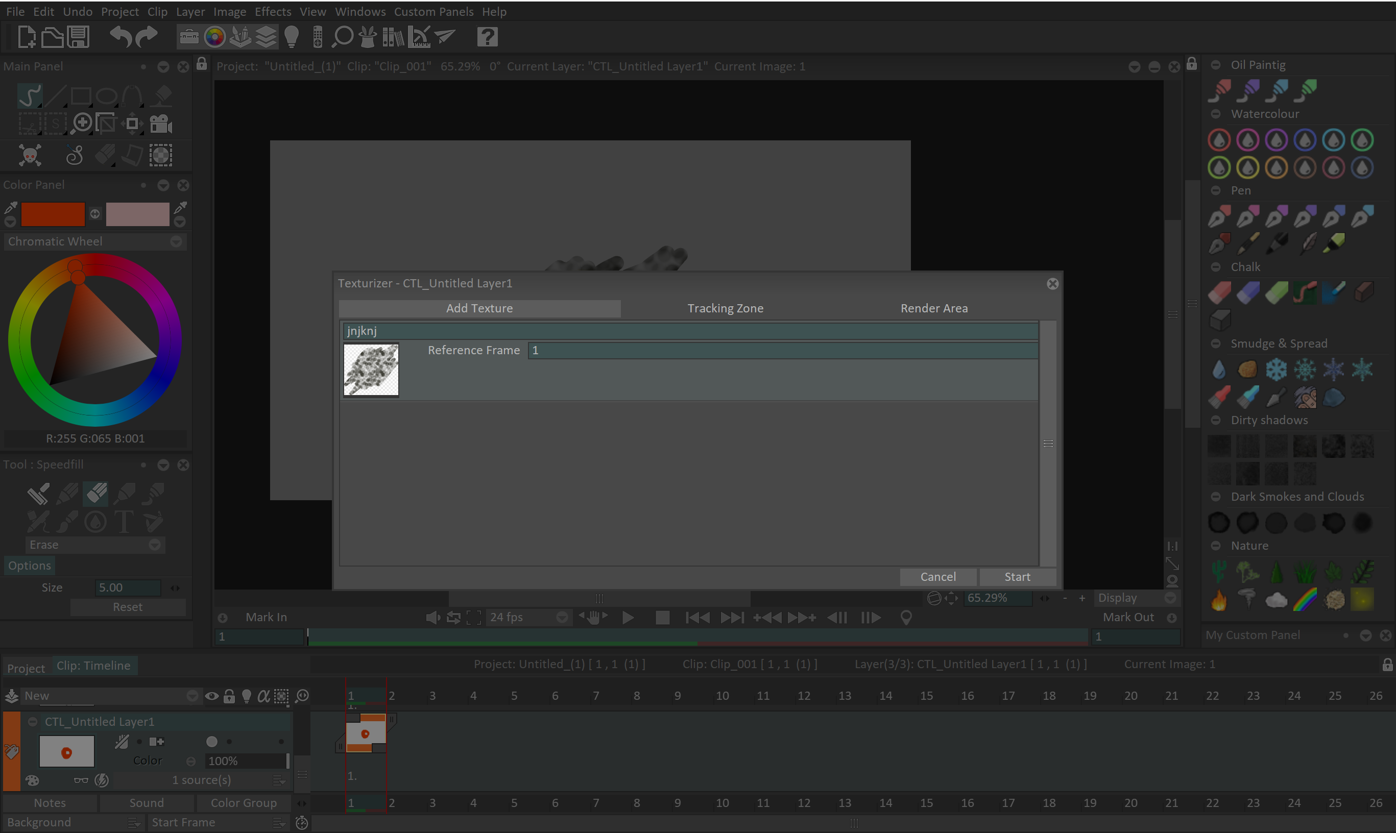

I also just watched the tutorial and have almost the same problem. The difference is that I can't find the "Select Color" button for Tracking Zone and Render Area.
Can anybody help PLZ.

Posts: 1143
Re: Importing Texture in CTG layer - not correctly configured
Hello, I posted a solution to your problem on this thread: https://forum.tvpaint.com/viewtopic.php ... 12#p131912
