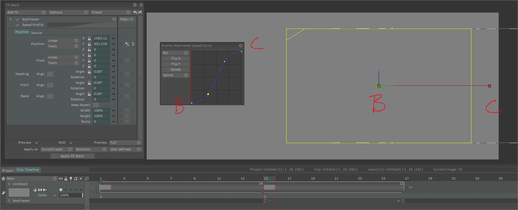

Done a nice keyframe move with a few different keyframes and I want the moves to have a bit of an ease in and out. So I use the Speed Profile to add a slight curve in and out, but when I do that, the move gets totally messed up starting way after the actual keyframe positions. I can see that I am not supposed to just add a single curve, but it's confusing how I do this for multiple keyframe positions. I want each keyframe to have the same gentle ease in and out. What's the simple way to do that?

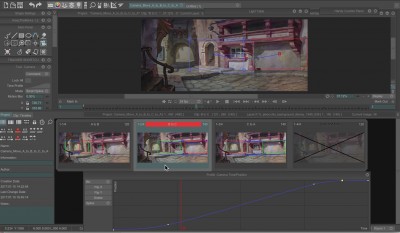

-In the Project tab, split the Clip (scene) into 3 separate Clips, A to B (120 frames) , B to C (140 frames) , C to A (140 frames)
(Split Clip in the Clip Menu)

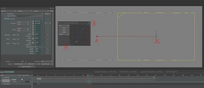

-Now you will have to set 3 simple (2 point) Camera Moves.
- set Camera position for Pos. A and Pos. B in the first clip , with the slow-out/slow-in on the Time Profile . (remember that a flat line will be a HOLD with no movement)

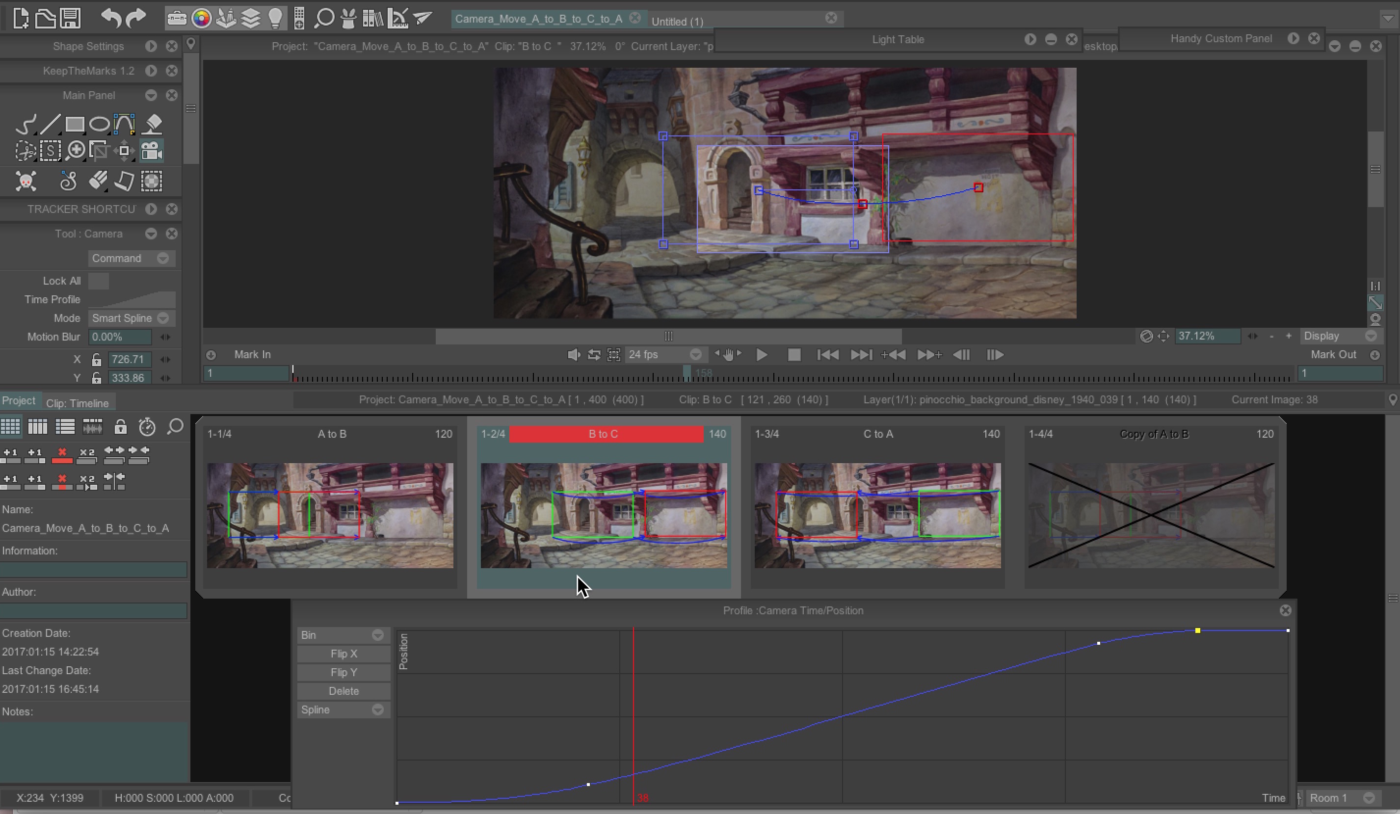

- go to next clip B - to - C : RMB click on the center point of the camera field = "Copy last point of previous clip" to precisely copy the last position of the camera from Pos. B into the start of the second clip , then set the camera position for Pos. C.
- go to next clip C - to - A : RMB click on the center point of the camera field = "Copy last point of previous clip" to copy the last position of the camera from Position C into the start of the third clip . Since you are going back to Pos. A from Pos. C instead of creating a new Pos. D , you should also go to the first Clip "A -to - B" in the Project view and select that clip, Copy , then Paste it AFTER the third clip , so now for your final camera position you would RMB click on the center point of the camera field = "Copy first point of next clip" . (You see ? So that will exactly copy camera Pos. A into the the third clip, so the camera returns precisely to that starting point . After you've done this you can hide or delete the copy of clip A to B .)

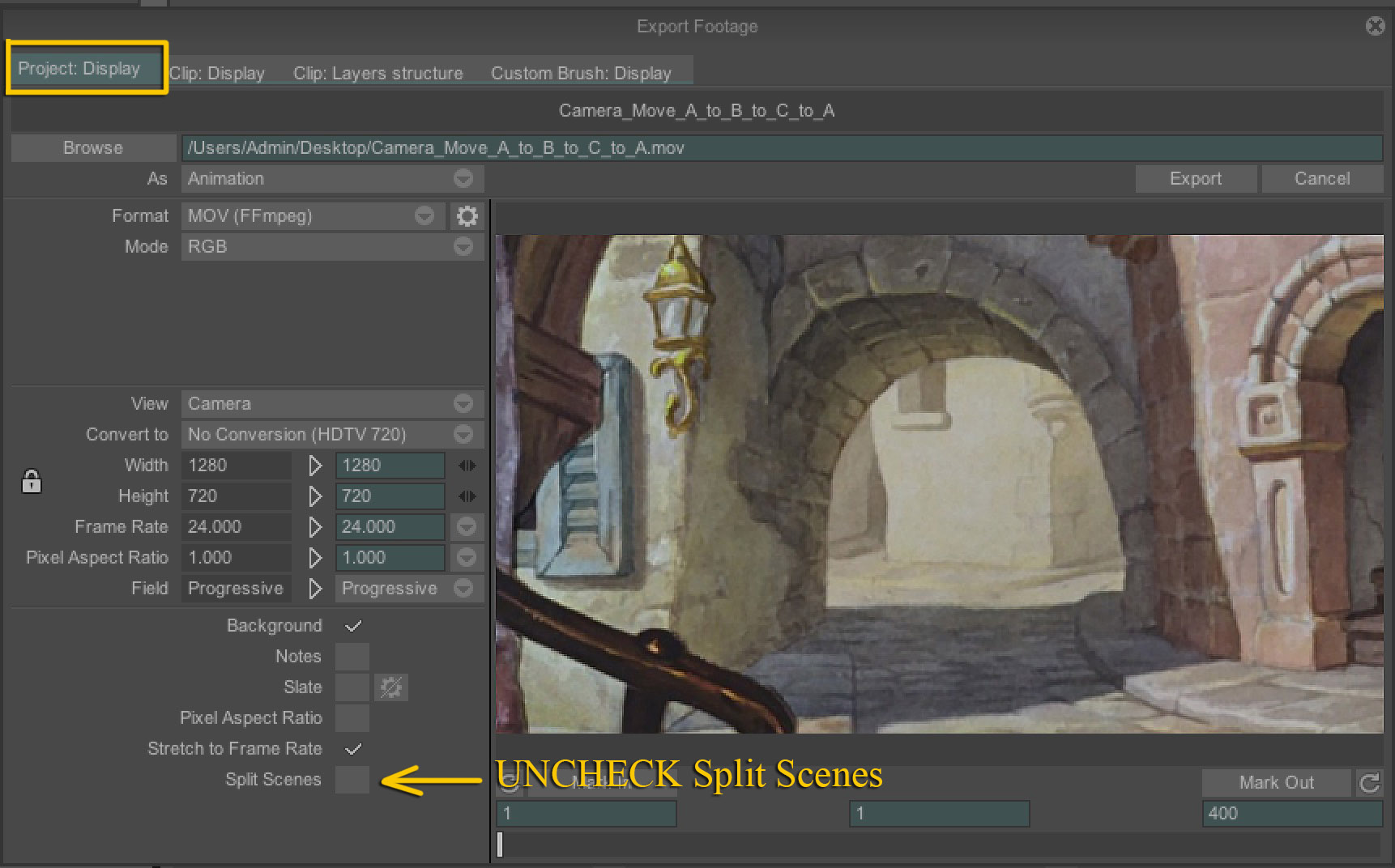

Also, I have exported the three clips separately, but is there a way to have three clips, as I do, but export them all together as one file?
Yes. When you export from Project Display tab uncheck the box next to Split Scenes. This will export all three Clips as a single continuous clip , instead of as three separate clips.
