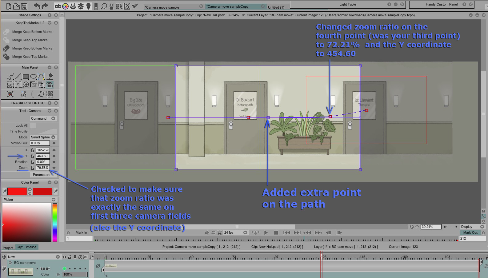

So , here's what I was able to come up with after some fiddling around with it (see attached ; the .tvpp file is in the zipped file 'Camera Move Sample_New_Move.zip' ).
I added an extra point on the path (after your second point ) and I adjusted the zoom ratio on what was your third point (now the fourth point) to 72.21% . Combined with the new third point , this overlapped the point where the zoom-in starts.
On the first three points I made sure that the zoom ratio was exactly the same on each one (79.58% ) and the Y coordinate was exactly the same (463.60). Only the X coordinate changes as it moves from left to right .

Thank you. This is really helpful. So it seems that adding the extra position helps look it. Also, I had not typed in the Y and Z coordinates to match absolutely exactly, and that seems to be vital. I find that having done that, if I want to select a position to check the coordinates, clicking on the little box inevitably moves it a few pixels. Is there are way to move from one key position to another without clicking on the screen? They way you can do that in the Keyframer FX panel?
Re: Camera move troubles
Posted: 14 Feb 2017, 19:08
by D.T. Nethery
David_Fine wrote:Thank you. This is really helpful. So it seems that adding the extra position helps look it. Also, I had not typed in the Y and Z coordinates to match absolutely exactly, and that seems to be vital. I find that having done that, if I want to select a position to check the coordinates, clicking on the little box inevitably moves it a few pixels. Is there are way to move from one key position to another without clicking on the screen? They way you can do that in the Keyframer FX panel?
If it shifts slightly when you click it , just immediately hit Undo (CMD Z), and it will snap back to the previous position.
I would use the mouse rather than the pen . When I click on it with my mouse it's less apt to move.
You can use the coordinates slider arrows in the Tool Panel to avoid touching it (but this doesn't let you click from position to position ... for that you have to use the mouse)
