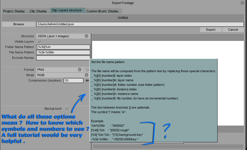

I'm still interested in knowing more about how the JSON export could be used to generate an Excel spread sheet that has only the instance names in the columns , but not the layer name and frame number .
Also, It would be a great help to have a full tutorial on using the JSON export function. There are things about the folder naming structure and file naming structure with all the various brackets [ ] and % and various numbers 04, 05 , that I don't really understand ... an example is given in the pop-up inline help : -%5ii-%08in ... Ok, but what do those numbers and symbols mean ? Why does entering those specific numbers and symbols make a difference ? If I change the numbers to something different, like -%4ii-%06in , does it have an effect ? The only way to find out for now is trial & error testing ... with no tutorial explaining the parameters for the JSON export in detail it makes for slow progress by trial & error to figure out how to configure it.
