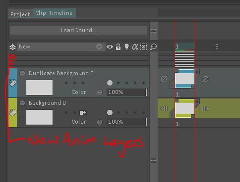

Recently bought TVPaint and liking it so far. I've run into an issue when adding new Anim Layer that they appear minimised and unworkable. It doesn't affect the Background or Duplicate Background layers, only the Anim ones. The last thing that I was doing before this happened was trying the Stroke Animator option. It's affected all projects I created up to that point. I restarted my PC and still the same issue with those projects and happening when create new projects.

Re: New Anim Layer issue
Have a look here:
https://www.tvpaint.com/doc/tvp11/index ... esentation
https://www.tvpaint.com/doc/tvp11/index ... -show-hide
Perfect! It was the default colour group was unticked. Thanks a million!D.T. Nethery wrote: ↑07 Mar 2017, 00:22 Have a look here:
