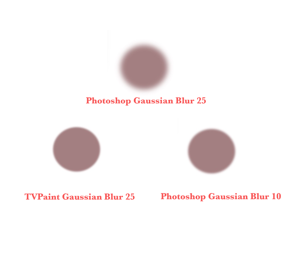

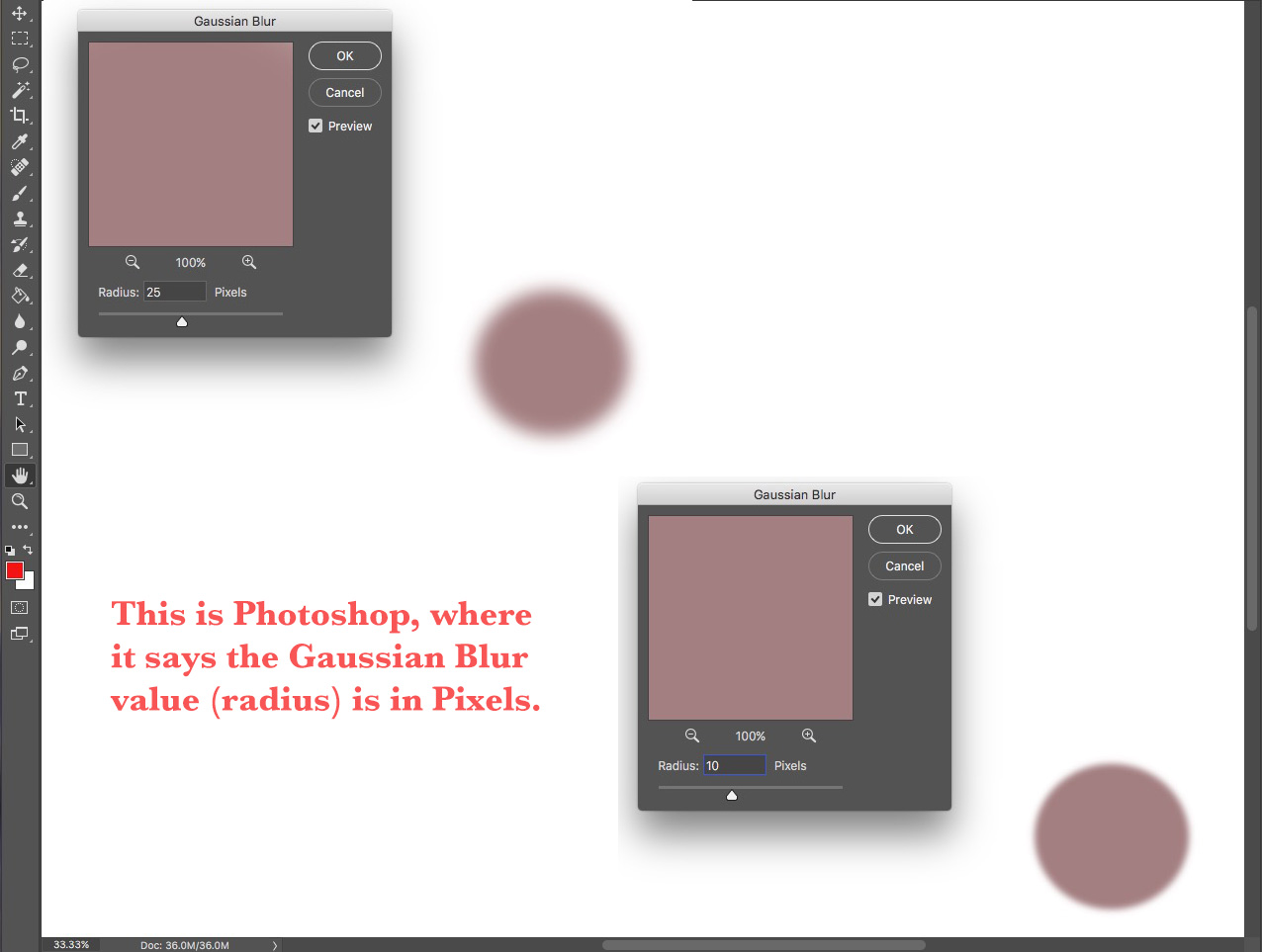

I'm trying to coordinate with an art director who is doing his work in Photoshop because that's what he is used to , and I'm doing my work in TVPaint, following the style he is setting. In the scenes we are coordinating we have several effects layers that have Gaussian Blur applied .
When applying the Gaussian Blur FX in TVPaint what do the numerical values in the Width and Height box represent ? I had thought that the values were in Pixels , but I notice that if I blur something in TVPaint with a value of 25 , in Photoshop a blur value of 25 is MUCH more blurred than in TVPaint . In Photoshop a Gaussian Blur value of 10 is similar to Gaussian Blur of 25 in TVPaint . So what do the values in TVPaint represent if not pixels ? (and if they are pixels then why does blurring with a value of 25 in TVPaint look much less blurred than using a value of 25 pixels in Photoshop ?)

Re: Gaussian Blur values/radius in TVPaint - what is it ?
Posted: 30 May 2017, 21:15
by slowtiger
Just tested.
PS 5 ≅ TVP 15
PS 10 = TVP 30.

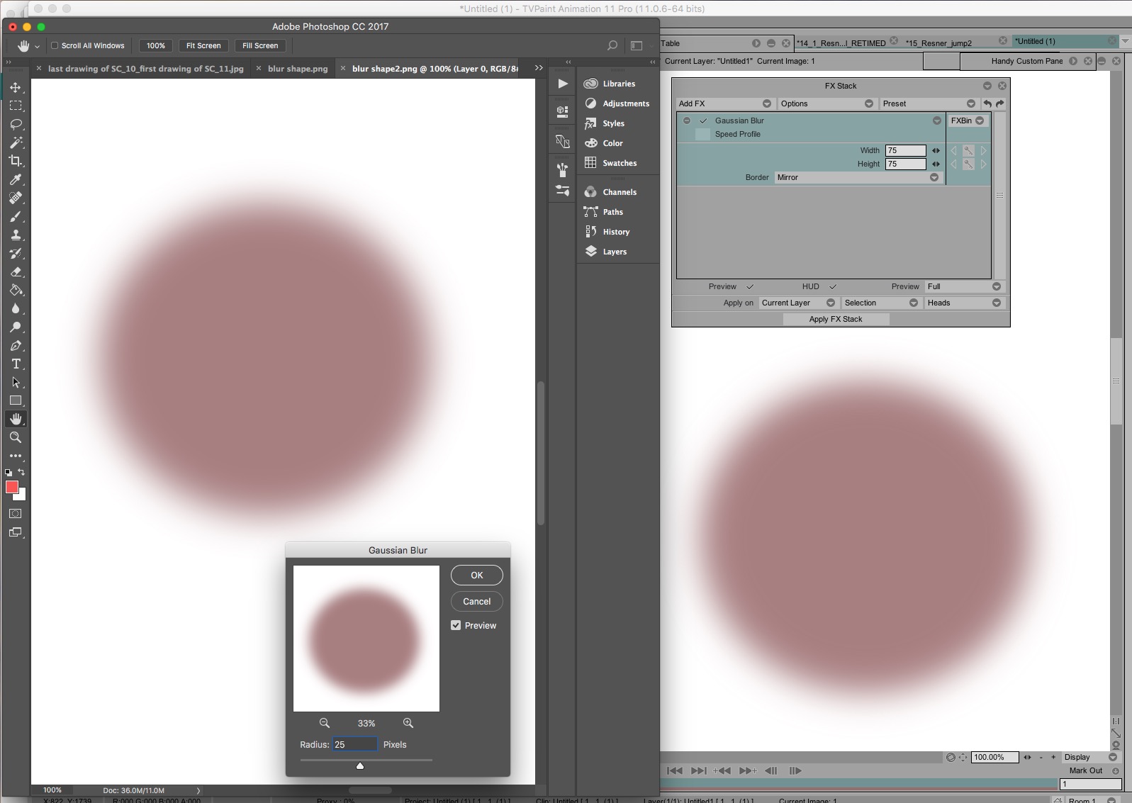

Posted: 30 May 2017, 21:22
by D.T. Nethery
slowtiger wrote: 30 May 2017, 21:15 Just tested.
PS 5 ≅ TVP 15
PS 10 = TVP 30.
Thank you for confirming , Slowtiger . I was just about to post that I tried comparing PS and TVP side by side and it appears to me that a Blur Value of "25" in PS is equivalent to a Blur Value of "75" in TVPaint , so that is the same as your findings: PS is 1/3rd the blur value of TVP to get the same blur effect.
I'm still curious to know exactly what do the values in the TVPaint Gaussian Blur represent , if not 1-to-1 pixels ? Why are the blur values in TVPaint 3x the pixel value
of the same amount of blur in Photoshop ? I would imagine that is somewhat confusing to other users , too .

NathanOtano wrote: 31 May 2017, 06:54
Well, maybe it's about the algorythm that is different?
Ok, yes, I get that , that's fine , but I would hope this is something that someone from the TVPaint Dev. team could jump in to explain, how the Gaussian Blur values are expressed in TVPaint ... (?) .
Most graphics/animation programs that I'm familiar with (Photoshop , ArtRage, Toonboom) use Gaussian Blur values in Pixels . TVPaint is different ... ok, I get that . In many functions TVPaint is different and I don't worry about it (because I absolutely ADORE TVPaint, please let me emphasize that ) , but in TVPaint it's a bit confusing because some FX Stack values ARE expressed in Pixels (such as Erode or Border or Toon Shading) so why is Gaussian Blur different ? Why doesn't the User Manual say anything about it , like : " Please be advised that the Gaussian Blur value in TVPaint is 3x the Gaussian Blur value in well-known applications like Photoshop " . ) This wasn't a huge issue for the production I'm currently working on , it only cost a couple of hours or so of research to figure out that Gaussian Blur in Photoshop is 1/3rd the value of Gaussian Blur in TVPaint , but does this really need to be so different ?
