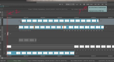

Hi,
When I press this button (1), cursor goes to beginning (2)
However, if I use a shortcut (shift+tab in my case) it works as expected (goes to the first frame of current layer.)
I was looking to set up a hotkey to go to the first frame of the whole clip, but I run into this thing. Bug, or what?
Windows 10 (64 bit), 8gb ram, intel i5 10400f. TVpaint 11.7
Re: go to first frame inconsistency
I think the button is here to go on the first frame of the Clip, not the first frame of the layer.
EDIT : ok, it seems to be a bug.

Ok, good to know.

I confirm the same bug that kariP reports.
