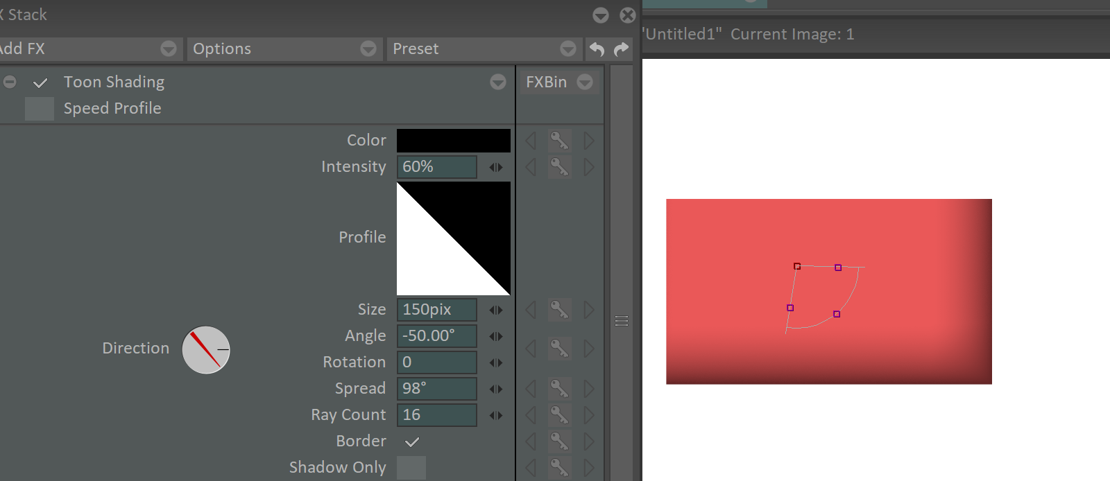

Hello,
Actually the Toon Shading FX allows you to cast a shadow inside your character, on the contrary the Drop Shadow will cast a shadow outside of it.
FX Stack > Add FX > Stylize > Toon Shading

This topic may have some information that points you in the right direction on how to make adjustments with the Toonshading FX (and also a clever application of the Drop Shadow FX that Elodie came up with) -
https://www.tvpaint.com/forum/viewtopic ... 10&t=10814
In my experience , the Toonshading FX works best on very simple shapes with very soft shading . If you have more complex shapes which need precise shadows and highlights which conform to the shapes it is better to draw the shadows and highlights on different layers
