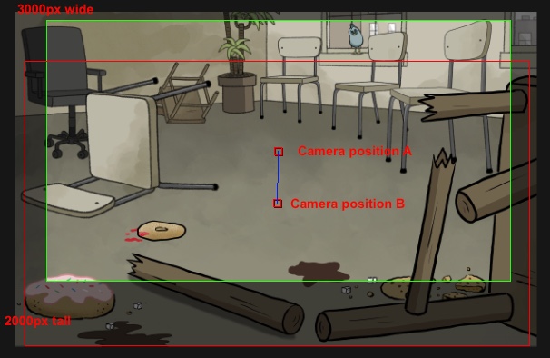

Let me put it another way. Here is the set up with the A and B camera move and the overall image size. So for maximum resolution, given the project size is 3000 x 2000, what should I set the output at?

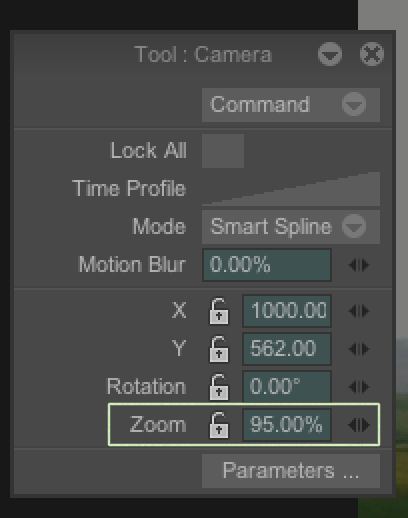

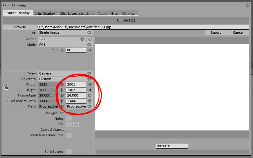

You have everything you need: The cam resolution and its zoom value.
1. take the value of the zoom (let's say 120%) and set the zoom to 100%
2. recalculate a new cam resolution: 1920 x 1.2 = 2304 px
3. set the cam resolution to 2304 px
4. render this frame and it should be in the native resolution of the project
If the camera is not zooming (just moving) you can export the camera for the hole movie. If the cam is zooming, you have to repeat steps 1. to 4. for every frame - ending up in a stack of images ... as said before.

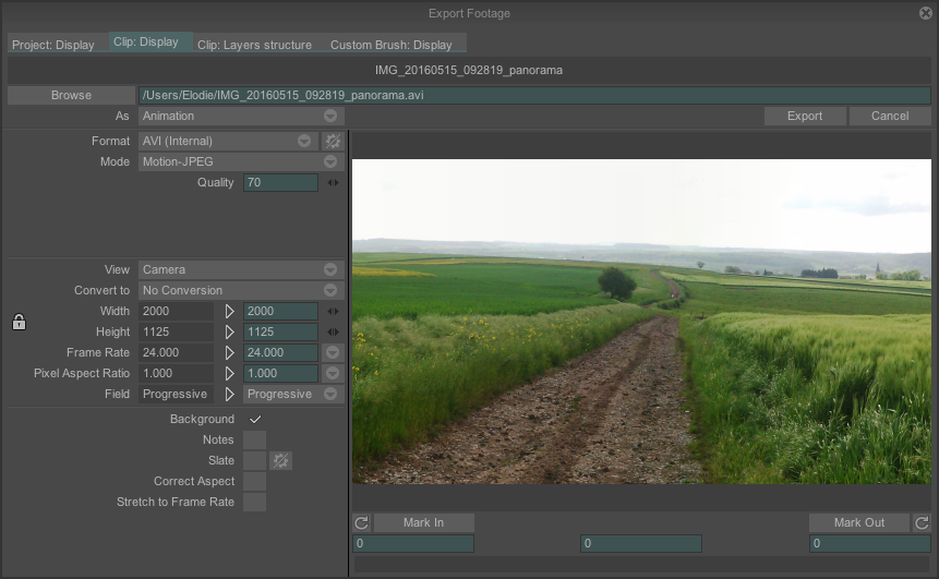

Re: Export resolution issue
A little reminder about Resolution and Definition, let's not mix both :)
Camera tool acts like a crop or a magnifier, depending on the zoom ratio.
If your camera is 2900 pix wide and zoom ratio = 100% -> when you export you project with the camera view, your project will be cropped to 2900 px wide.
If your camera is 3000 px and you lowered the zoom ratio (96,6675%) -> the display of the camera will 2900 pix wide, but will be exported as 3000 px wide, which means loss of quality.
Here is an example of a project being 2000 x 1125 and we want the camera to be 1920 x 1080...
In other words, here is the good method :
good camera settings.png (88.54 KiB) Viewed 40432 times
So the project is exported in 1920 x 1080
Here is the bad method :
bad camera settings.png (22.45 KiB) Viewed 40432 times
The camera zoom is low, but it won't reduce the size of the project (it keeps a definition of 2000 x 1125)

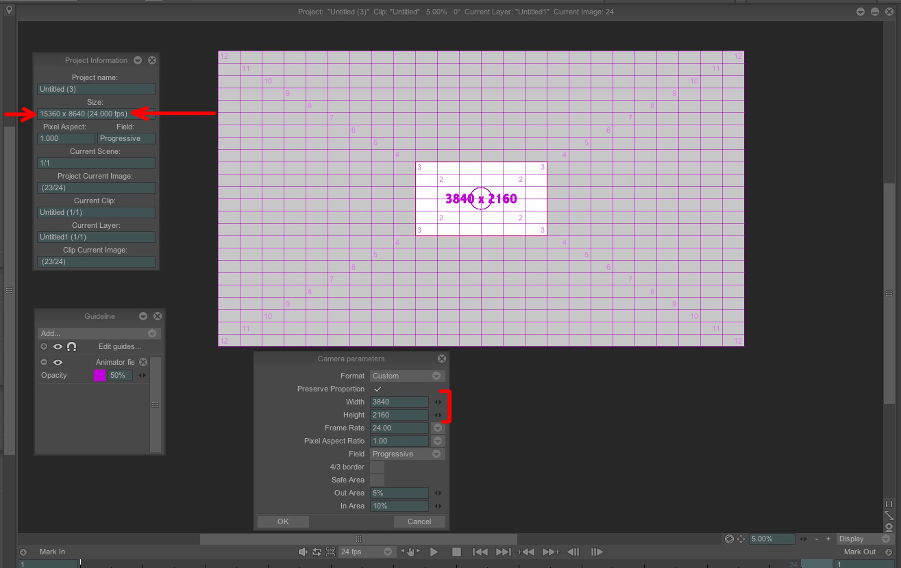

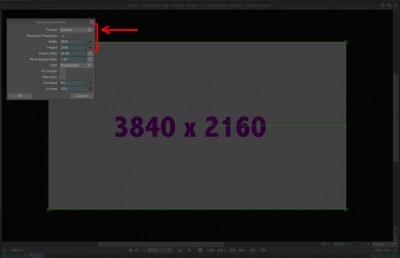

Well, if the original project resolution is 3840 × 2160 (which is DCI 4K UHD resolution for 16:9 aspect ratio) and you want the output to be at that same resolution , why not just set the Camera Parameters to a Custom setting of 3840 x 2160 instead of HDTV 1920 x 1080 camera parameters ? It's the same 16:9 aspect ratio . If necessary you can always scale it down later to 1920 x 1080 or 1280 x 720 for distribution on the internet (YouTube or Vimeo or iTunes) . I'm assuming your original resolution is intended to be digitally projected on a large theater screen. With 4K digital projection becoming the standard I would think you would want to keep that resolution of 3840 × 2160 UHD .
Obviously no problem for a shot with a locked camera with no camera move. Of course , if you want to zoom-in closer or pan north-south-east-west , you have to over-scale your project size , so you might work at something like 7680 x 4320 , with camera parameter set to the intended output of 3840 × 2160 , so that would be the size it renders to with Camera View selected in the Export panel. The rule would be that the smallest camera field has to be equal to the intended output ( 3840 × 2160 ). So any camera field working within that larger 7680 x 4320 will have sharp resolution as long as you don't field in closer than what would be 100% camera resolution of 3840 x 2160 . (although my own tests show that I can go in a bit further than 100% zoom ratio ... I tried at test where I started at 200% and zoomed in to 75% and the final image still looked sharp to me ... with the caveat that I'm viewing it on a computer monitor , not a large HDTV or a theater screen . If your film has a technical director I'd consult with them to find out the limits you can push it to before you'd need to necessarily scale up the resolution of the original project size. To be safe I don't think I'd push it beyond 90% . If I had to get in closer I'd switch to a higher starting resolution . See next example.

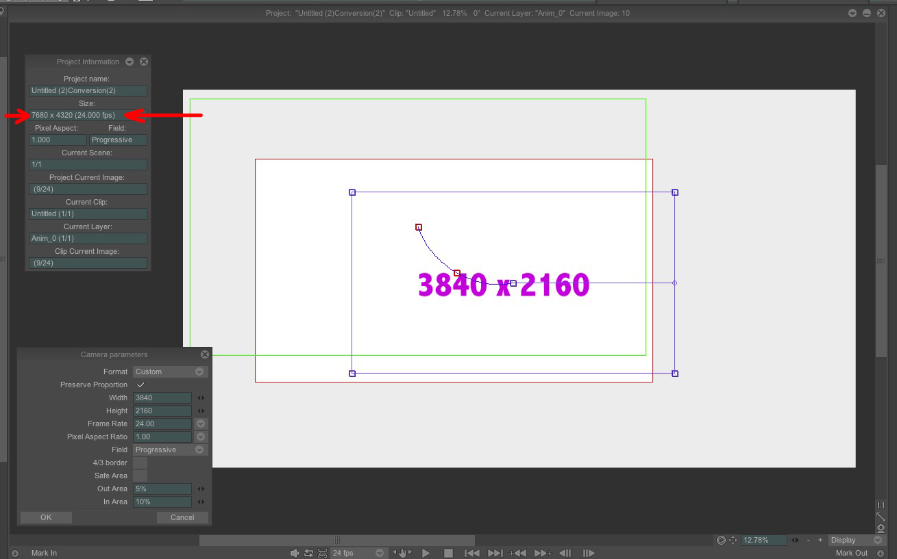

If you had a shot with an extreme zoom-in from a wide field to a very tight field, what would be equivalent of a move from "12 Field" to "3 Field" (as we would have talked about in ye olden days of 12 Field graticules/field guides) then to maintain maximum image sharpness throughout the entire range of that long zoom-in (from "12F" to "3F") you'd have to over-scale the project resolution to 15360 x 8640 , so by the time the camera got to the "3 Field" position it is still at 100% camera resolution of 3840 × 2160 . At that extreme size of 15360 x 8640 I would imagine a long scene that had many frames and multiple layers would have very laggy performance unless you're using a computer with a very fast processor and a lot of RAM ... so my tendency would be to never plan a scene for a continuous zoom-in (or zoom-out) over that wide of a range , but figure out a way during layout to split it up into two or three different scenes that would hook-up seamlessly to avoid any visible "jumps" during the zoom. (see this : https://www.tvpaint.com/forum/viewtopic ... 820#p20783) But I'm just using this as an example for talking about the Project Resolution compared to Camera Size compared to final Output Resolution .
