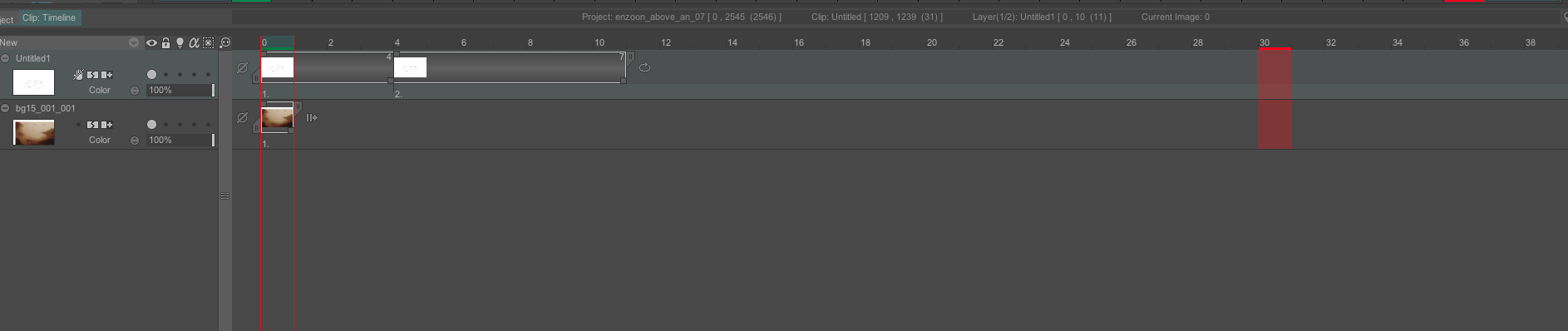

I often have clips where I "Hold" or "Loop" a layer. When I then have a Mark Out point (that is ON), further away in the timeline, but no layer reaches the Mark Out point ('cause for example I didn't stretch out the Holded layer to the Mark Out point, it stops rendering to where the layer ends. So the render does no longer look at the Mark Out point, only at the layers.
Maybe I'm talking gibberish now, so I've added screenshots.
Here it only renders until frame 11 instead of 30.
Screen Shot 2018-02-05 at 17.04.59.png (48.36 KiB) Viewed 19432 times
On the first one you can see the layers of one of my clips. A layer on hold, and a looping layer, with a Mark Out point further in the timeline. Upon normal preview playing, or rendering as a clip - no problems. But they do give problems when I render the entire project and use 'SPLIT SCENES'. It then stops rendering that scene at frame 11 instead of 30.

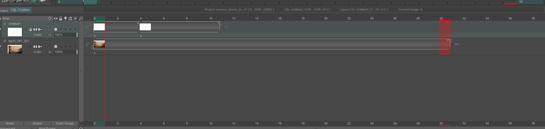

Here is how I have to change it in order to render until frame 30.
Screen Shot 2018-02-05 at 17.05.09.png (58.91 KiB) Viewed 19432 times
The second image is what I then have to change throughout my entire project, to no longer have those issues.

This is something which happens in normal export, too (being in clip view). An Out mark somewhere behind the last frames of all layers is plainly ignored, if I want a video exactly that long I need to extend any one layer to that mark, even with an empty exposure.
Yes, I think this should be fixed.

I just put my held frame at the end :D
It is a little counter intuitive though. I agree.

Haha that is an option! But indeed, you already have to think of it, just as if I now lengthen one layer until the Mark Out point.
But then you already need to know the end point (or take the time to change it afterward). With an animatic I often lengthen or shorten the timing, so I use Mark Out points a lot for changes in timing..
Hopefully it can be fixed in the future!

slowtiger wrote: 05 Feb 2018, 17:07 This is something which happens in normal export, too (being in clip view). An Out mark somewhere behind the last frames of all layers is plainly ignored, if I want a video exactly that long I need to extend any one layer to that mark, even with an empty exposure.
Ah could be, actually! Didn't notice it since I haven't exported single clips recently, but you're right!
It's indeed the same issue you address, even though a layer is on 'hold', it doesn't count until one layer is extended until (or past) the Mark Out point. Then it works correctly, and renders until the Mark Out point.
Glad I'm not alone :wink:
