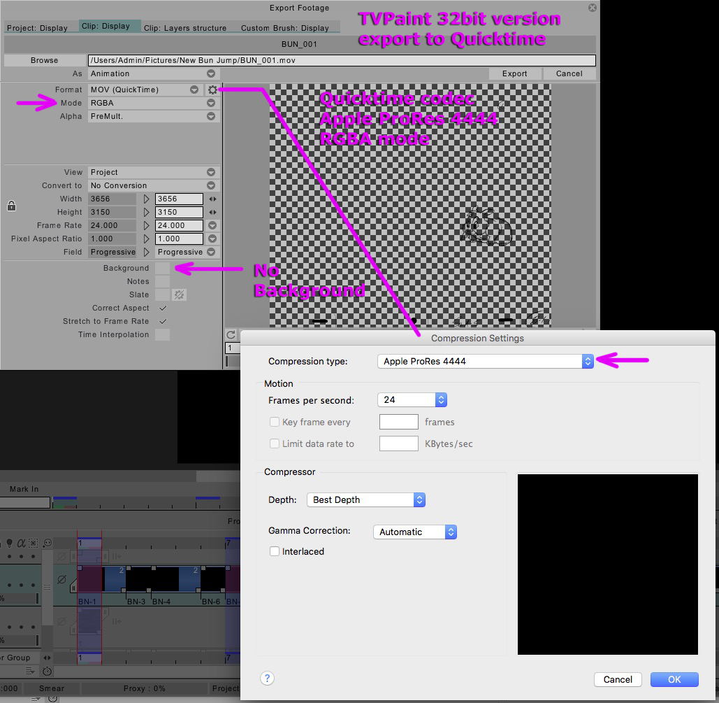

TVPaint 32bit using Quicktime -
compression codec = Apple ProRes 4444
RGBA Mode
No Background

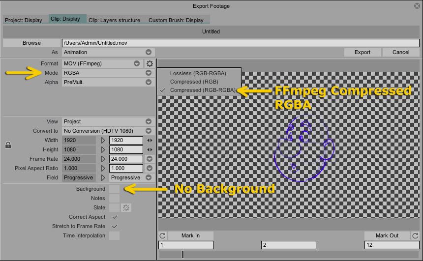

TVPaint 64 bit using FFMpeg-
Compressed - RGBA mode
No Background
