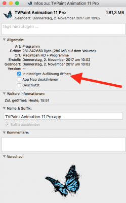

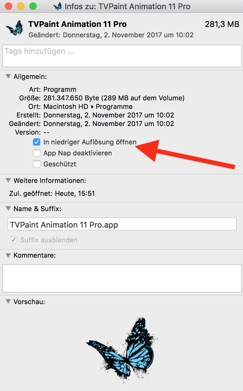

Re: Guideline, timeline notes, etc - causing slow pen performance.
Yes, I have the same issue when running TVPaint in high resolution mode.
Right-click on the TVPaint App and go to Information. Then try to tick the "open in low resolution mode" box. See if that helps.
When I tick the box TVPaint works without lag.

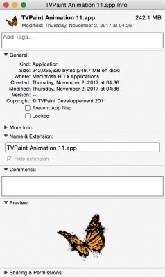

Thanks for the tip and good to know I'm not alone with this issue. However I don't have that option in my info panel:
