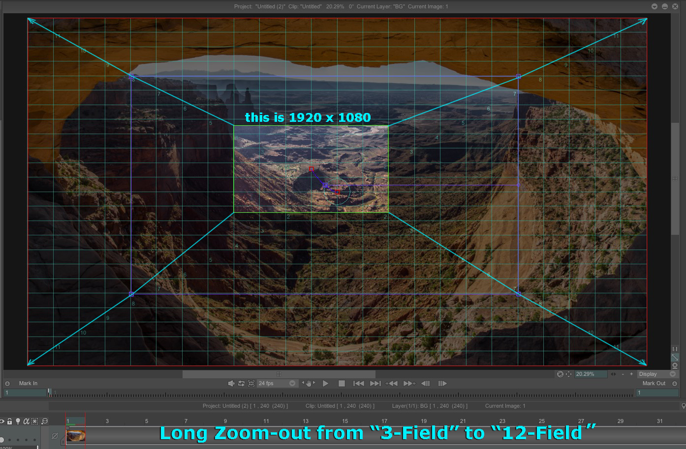

Yes, the best policy is to work over-scale if you're going to zoom-in close on details (or in this case enlarge the size of the distant plane on the multiplane stage). The usual formula would be that the most extreme zoomed-in area should be equal to the intended final output resolution , so let's assume your final output will be 1920 x 1080 ... if your distant plane is zoomed in 400% from where it ends up at the end of the camera pull-out , you would need to work 4x over scale at 7680 x 4320. That would be equivalent in traditional animation terms of zooming-out from "3 Field" to "12 Field" . If you want the image to be crisp throughout the range of the zoom-out then the "3 Field" area needs to be equivalent to 1920 x 1080 (the intended output resolution) . A zoom-out equivalent to "3 F" to "12 F" is an extremely long zoom , so maybe yours doesn't need to be that much ... if you were starting so that your most distant plane was zoomed-in 300% then you would need to be 3x overscale at 5760 x 3240 ... that would be equivalent to zooming out from "4 Field" to "12 Field' , which is still a rather long zoom-out . 2x overscale would be 3840 x 2160 .

But maybe try this solution, of breaking it up into sections (that will seamlessly hook up) so that if you're doing a very long zoom (400% - 500% , 800%, whatever it may be) you don't have to scale up the project that large -
viewtopic.php?t=4841
