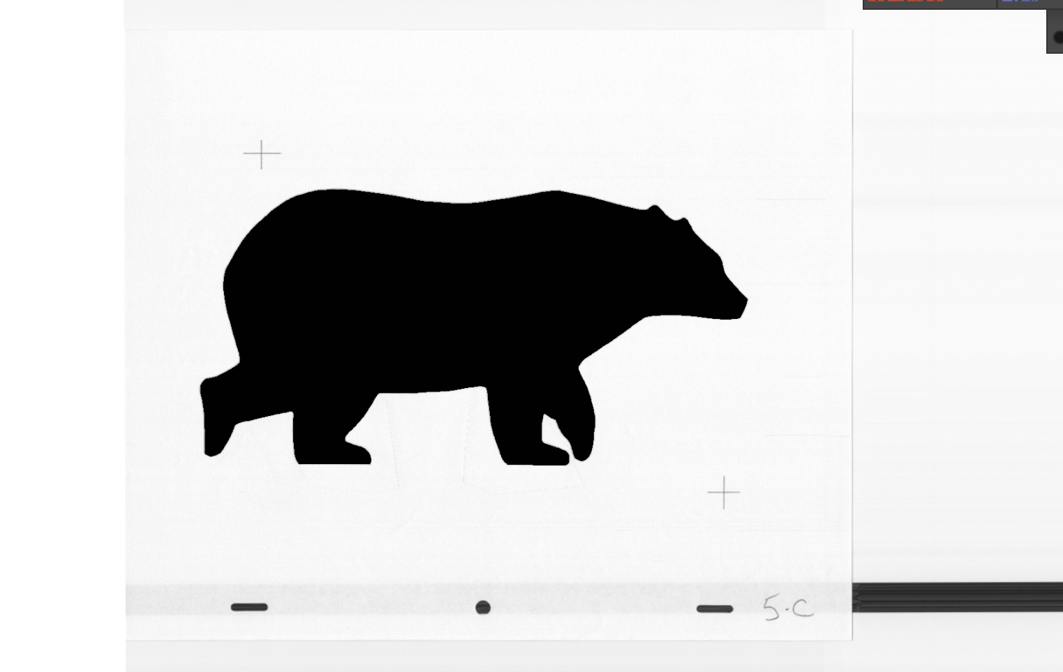

DT, I'm going into the Histogram and moving the little needles to adjust the white levels, but it doesn't appear to be affecting the image in any way. I'm clearly doing something wrong.
That said, I thought that it might make sense to first show you a frame of my animation to see if this is indeed the best process for this particular issue. I would like to make everything around the bear pure white.

The Histogram, like many FX, only works with RGB values, not with alpha, so applying it after the Scan Cleaner doesn't work. You need to test it with one of your original scans where the white and grey areas are still opaque. (It's the same in Photoshop.)
Your workflow should be:
1. scan
2. Histogram (make all grey areas white)
3. Scan Cleaner.

BruceM wrote: 28 Aug 2018, 16:34 DT, I'm going into the Histogram and moving the little needles to adjust the white levels, but it doesn't appear to be affecting the image in any way. I'm clearly doing something wrong.
It is what Slowtiger mentioned : the Histogram FX needs to be applied BEFORE the Scan Cleaner FX . OR as Svengali suggested, use Color > Curves > Alpha to adjust layers that have already had Scan Cleaner applied.

Thank you so much DT! That worked beautifully on the already Scan Cleaned frames.
Very helpful for a numbskull like me to have the video to follow!
