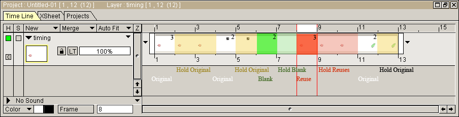

I have been playing around with TVP demo this weekend I have have come up with some suggestions :-).

ok back to timing I its crusial that youcan time your animation, on your animation layer.
And I think some color coding is importent for better/faster working.
On the timeline(and xsheet);
I think there shold be shown at least
* original drawings
* hold frames (show with brown on my example)
maybe it also could be nice with
* reuses (red) drawing 1 appears again on frame 8
* and hold reuses(lighter red)
Maybe it also could be bice with a symbol for blank fames then the assistent can see where to put the inbetweens? or maybe its to much??
*Blank (green)
*hold blank(lighter green)
I also think it could be nice with a number indicating how many frames the drawing is hold
When you step the default step should be to skip the hold frames. you only whant to work on your drawings. and the there should be some functions for making a hold frame a original . reuse to original etc.

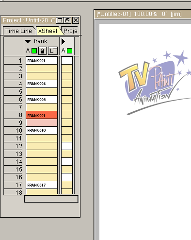

hnmmm... on second thought it would be a good idea with name on the
"original frame"(Like take2), if you are want to xsheet a "stagger" or lipsync.
I havn't done much of that, but now I realize Its maybe because I didnt have the possiblity.
if there is text on the original I actually think the vertical timeline is best:
then the with of the frame colonne would be the same
And it is easyer to align original across layers.
I used Cell action 2d the last couple of month and it has a traditional xsheet and i used it alot.
a last note I think that the original should have the name of the layer and the frame it appears first in time.
this means when you alter you timing you are altering the names to, maybe it could be a good idear to have the possibility to give an original an original name like: "frank A" or "frank happy" if you making limited lipsync alot
