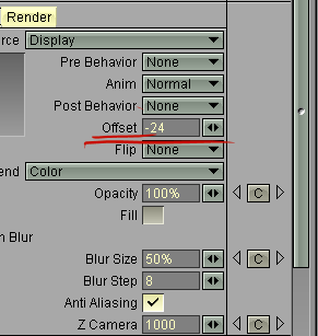

hisko wrote:... Of course it's possible to use display as source, but then the display and the new layer are visible at the same time, making it hard to see what I'm doing.
I can see 2 ways actually to achieve that :
1) - Duplicate Project,
one as source (the 3 character's layers visible),
but hide them in the destination project where you will apply the Keyframer FX,
2) - Offset in the timeline your target (FX) AnimLayer,
to make it start after the end of the 3 character's layers source,
then set the Render/Source to "Display", and "Offset" (negative value)
so the first frame of your character appear into the first frame of your KF layer.
(hmmm... see pict., longer to explain tha to do! ) :wink:
hisko
Posts: 581
Joined: 03 Nov 2006, 19:43
Post by hisko »
Thanks a lot, Zig0tto. That works fine.
