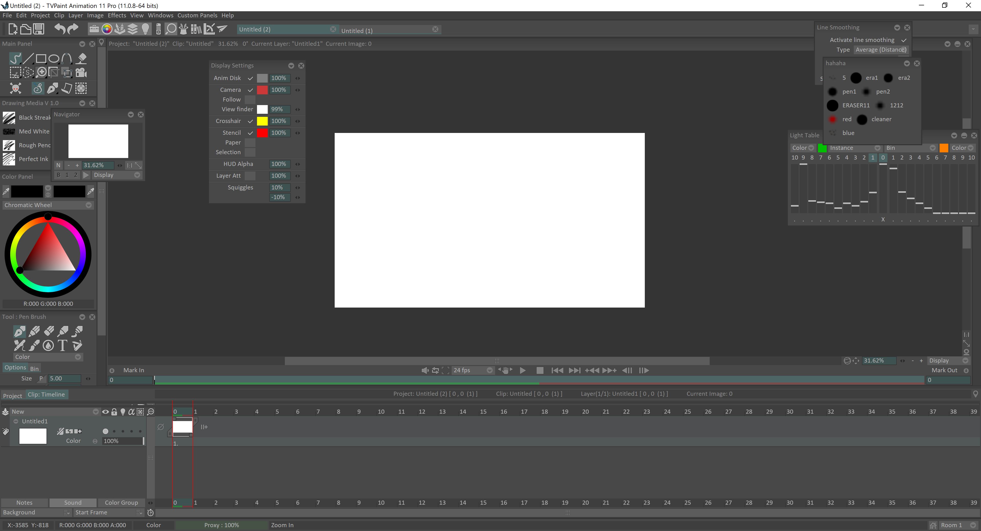

I set the drawing area 2times bigger than camera view. but even if I set that when I make new project, I still can't see the drawing area. is there any way to show drawing area? I can't find anything related with it.

Oh I meant, when I set the new project. I set the drawing area should be 2 times bigger than camera view in ratio which you can check in the photo copy I attach. I can't see the extra drawing area that I could draw more out of canvas.

HannuriYu wrote: 25 Jan 2019, 11:38 Oh I meant, when I set the new project. I set the drawing area should be 2 times bigger than camera view in ratio which you can check in the photo copy I attach. I can't see the extra drawing area that I could draw more out of canvas.
Look in the Display Settings panel see if Camera is checked and adjust the opacity of the View Finder.

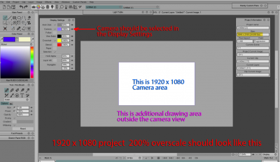

I made a New Project with the same dimensions as shown in your screenshot (1920 x 1080 + 200%) and this is what I see :
Make sure you have the Camera selected in the Display Settings (Windows > Show > Display Settings) .

well... the camera section is checked but still doesn't show up anything..

HannuriYu wrote: 25 Jan 2019, 15:40 well... the camera section is checked but still doesn't show up anything..
Click the camera icon in the Main Panel and it will appear.
See the box to the left of the 24 FPS in the play back bar under the project window? Click on that box to enable the camera view play back.
