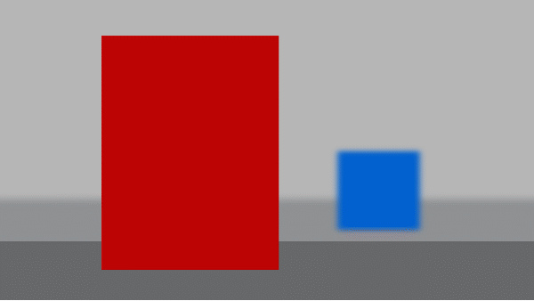

Re: How do you do shutter focus/blur effects in TVpaint?
holyax wrote: 11 Apr 2019, 11:47 Hi everyone! I have a scene with 2 layers, one is foreground and one is background. How do I make the layer with the foreground blurry for a few seconds and the the background normal? And then vice versa?
I guess its in multiplane camera somewhere
You could set up layers in the Multiplane Camera stage to get a rack focus effect , but as suggested by Slowtigre, you could simply apply the Gaussian Blur FX (FX Stack > Blur > Gaussian Blur) , by starting off with one layer blurred and the other sharp .... the first layer (blurred) has keyframes set to transition from blurred to sharp , the second layer (sharp) has the same keyframes inverted to transition from sharp to blurred.
YESSSSSSS!! Thank you so much!! Thats exactly what I wanted!!!
