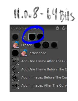

Ok .so there is no way of making the selected brush icon highlighted when selected?..
I just see in V.11 when selected a brush the icon is sort of highlighted wich makes it easy and fast to differentiate .
Thanks again for your reply.

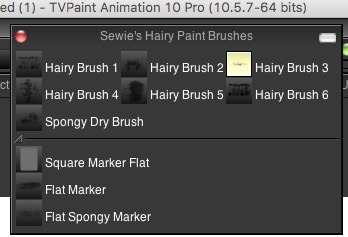

Oh, I think I understand better what you are asking now ... you want the selected brush to show as highlighted. I had thought it would be easier for you to differentiate between the various brushes if you made custom icons for them, but even if you did have custom icons for each brush, you want the brush to be highlighted when selected. I think it has to do with which interface colors you use for your TVPaint 10.5.7.
Here is a screen grab showing a tool panel in my TVPaint 10.5.7 ; notice the selected brush is highlighted.
This is the interface called InterfaceOSX.ini
There are many custom interface color designs available in this topic:
viewtopic.php?f=11&t=1313
Here is the one I use , InterfaceOSX.ini - viewtopic.php?f=11&t=1313&start=15#p61525 posted by user "Lukas" . One of the others posted in that topic may suit you better. I believe they all have the function where the selected tool is highlighted.
Here it is with the standard "Mirage" dark interface:
Here it is with the standard "Lorraine's Sky" interface :
After you have downloaded the custom interface .ini file , drop it into your TVPaint folder , then go to Preferences > Interface > Color Scheme , click on the drop down menu for color scheme and click on Open ... navigate to the folder where the custom interface .ini file is and select it.

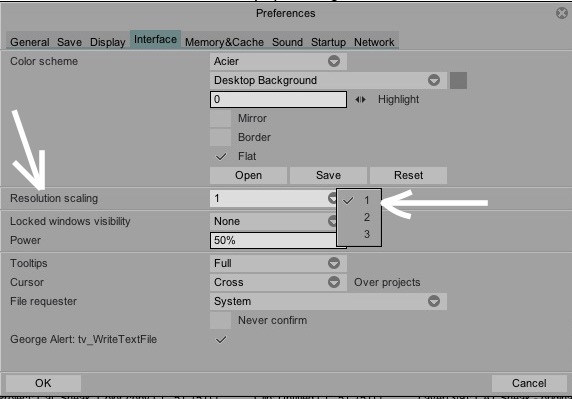

I am trying to figure out how to change the color scheme in the TVPaint interface. As I'm getting older, it's hard to see everything. I saw Aron Blaises and that looks a lot more comfortable than the standard interface. Any suggestions?
Also, to get better pencils do you need to upgrade to TVPaint Professional?
Re: Tvpaint 10,5,7 pro/Visuals indicator showing wich brush is selected.
Hello Wayne,
In the Interface Preferences, you have access to 2 predefined color schemes for TVPaint, the default one being Orage.
Just below is a collapsible menu allowing you to select an individual color for every part of the interface.
Regarding your question on brushes, the default sets are the same in TVPaint Professional and Standard.
Kind regards,
Kind regards,
Hi, Wayne ,Wayne Carlisi wrote: ↑16 Jun 2020, 04:06 I am trying to figure out how to change the color scheme in the TVPaint interface. As I'm getting older, it's hard to see everything. I saw Aron Blaises and that looks a lot more comfortable than the standard interface. Any suggestions?
In addition to the two standard interface colors , Orage (dark) and Acier (light) , you can further customize the interface as Dean mentioned in his post above. There is also a topic here on the forum under Contents Sharing called Share your Interface Look! where people have shared various customized interfaces, so you might find one there that is more to your liking. For myself , I find the standard Acier (light) interface easier to see.
To install one of the custom interfaces from the topic Share your Interface Look! , first you must download the file with the interface file (.ini) , then put the .ini file into your TVPaint folder in your Library (this is for Mac, if you're on Windows , I don't know where the TVPaint folder is kept on Windows ) . Then go to TVPaint , to the Preferences , to Interface . Under Color Scheme click on Open to open a custom interface . Navigate to where you have stored the .ini file , select it , then click on Load. You then have to quit and restart TVPaint for the new color scheme interface to take effect.
Also , keep in mind that if you are working on a high-resolution monitor, the resolution scaling can have an effect on how readable the interface is. If everything looks too small, try changing the resolution scaling . ( in the Preferences under Interface , Resolution scaling , your choices are 1 , 2, or 3 . Try which one looks best to you ... if you're on a standard size monitor , just leave it set to 1 )
All the pencils function the same in Standard edition or Pro edition, although some special blend modes may not be available in Standard edition (?). But just in terms of normal drawing with the pencil tools , they are the same in Standard or Pro. Many customized pencil tools available in the Contents Sharing forum.Wayne Carlisi wrote: ↑16 Jun 2020, 04:06 Also, to get better pencils do you need to upgrade to TVPaint Professional?

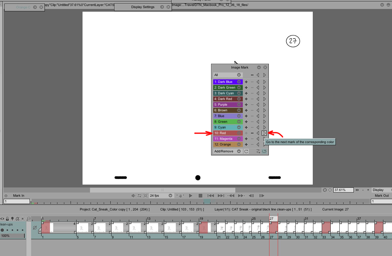

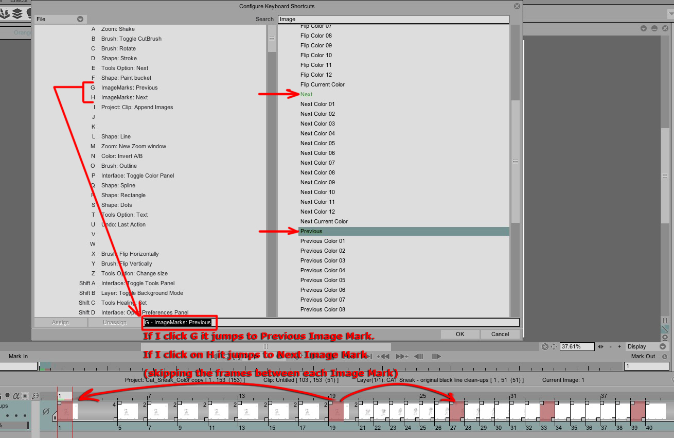

Het guys' hopefully my last question. How do I set up my timeline so when I scroll through, it lands on the first frame of a pose and not each frame individually? Again, I saw Aron Blase do a demo, but as I did what he was explaining it didn't work.
Thank you much,
Wayne
Thank you much,
Wayne
Wayne Carlisi wrote: ↑16 Jun 2020, 23:32 Hey guys' hopefully my last question. How do I set up my timeline so when I scroll through, it lands on the first frame of a pose and not each frame individually? Again, I saw Aron Blase do a demo, but as I did what he was explaining it didn't work.
Thank you much,
Wayne

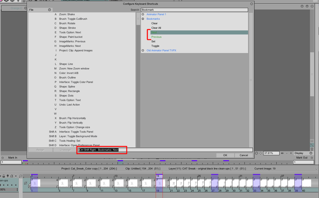

There are a couple of different keyboard shortcuts you can set up to flip between your keys/extremes, but skip all the frames between .
In the Keyboard Shortcuts you can set up Go to Next Bookmark and Go to Previous Bookmark, so it only will flip from bookmarked frame to the next (or previous) bookmarked frame , skipping all the other frames that are not bookmarked ....
OR you can set it up for Image Marks : Go to Next Image Mark and Go to Previous Image Mark.
See: https://www.tvpaint.com/doc/tvp11/index ... -bookmarks
and : https://www.tvpaint.com/doc/tvp11/index ... mage-marks
https://www.tvpaint.com/doc/tvp11/index ... es-general
For example , let's say you set all your Extremes as a Red image mark .... so 1 is an extreme , then the next extreme is 19 , then the next extreme is 27 , then the next extreme is 33 , then the next extreme is 39 , and so forth. If you use the keyboard shortcut for Next Image Mark and Previous Image Mark it will only flip from one image marked extreme to the next , skipping the frames that do not have he red image mark. I set my keyboard shortcuts as G = Go to Previous Image Mark , H = Go to Next Image Mark (these can also be mapped to Express Keys on your Cintiq or to the Touch Strip on your Cintiq to execute the Keyboard Commands G = Go to Previous Image Mark and H = Go to Next Image Mark.
You can also use the forward and back arrows in the Image Marks Panel to go to Previous and Next Image Mark.
Here's the set up I have for Go to Next Bookmark and Go to Previous Bookmark , which used keyboard shortcuts CTRL+SHIFT+Right to go to Next bookmark and CTRL+SHIFT+Left to go to Previous bookmark (these shortcuts are mapped to two different Express Keys on my Cintiq, so I can use either the go to next and previous bookmarks method using one set of express keys or the go to next and previous image mark using another set of express keys.)
So those are a few options for flipping between Extremes, but skipping the frames inbetween the extremes.
For navigation forward and backward along the Timeline set up the . (period) for Next Frame and the , (comma) key for Previous frame ,
but also set up your Forward → Arrow key for Next Instance , your Back ← Arrow key for Previous Instance, which allows you to navigate back and forth from one instance to the next or previous instance, rather than from one frame to the next or previous frame. Make sense?
See:
https://www.tvpaint.com/doc/tvp11/index ... s-instance
https://www.tvpaint.com/doc/tvp11/index ... -animation
