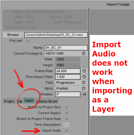

I noticed when importing a .mov file with audio into TVPaint as a LAYER the audio does not successfully import .
If I import the .mov file as a new Project the audio does import. But I need to bring the .mov file into an existing project as a Layer.
Can someone from TVPaint please confirm this is a known bug or is this only a problem I'm having on my end ?

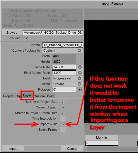

If there is no fix possible for this issue, then I would suggest the option which says "Import Audio" should be removed under the Layer tab , because the user will naturally assume that if such an option is shown in the Import window the audio will be imported ... it is frustrating when the audio is not imported. It would be better to not have the option listed if it does not actually work.
Under the Project and Clip tabs, leave the function "Import Audio" as it is now , because it does work if importing as a Project or as a Clip.
