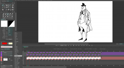

HI all, I sometimes use Turbulence displacement in AE to create a fake boil when I have a clean ink line. Is there an equivalent effect in TVP anyone uses? I've had a look but I can't see anything that would be practical.

Not as simple as a press of a button, but quite manageable:
Use FX -> Distortion -> Displacement Mapping with a layer of animated noise as source. I just did a test with some paper scans I had, increased contrast, enlarged and blurred it (see image, that's the whole frame). FX settings depth = 10, Smooth = 2. You can prepare several "noise loops" with different grain size for different results (for close-ups and wide angle), just a second each is more than enough. The result flickers a bit, maybe set the noise to 2's. If you need smoother boiling, you could prepare a really animated texture. Of couse you get a better result if you draw with an animated brush in the first place which gives you a good random width line each time.

Ok, displacement mapping with a 4 point plasma animation worked quite well actually. Thanks!
