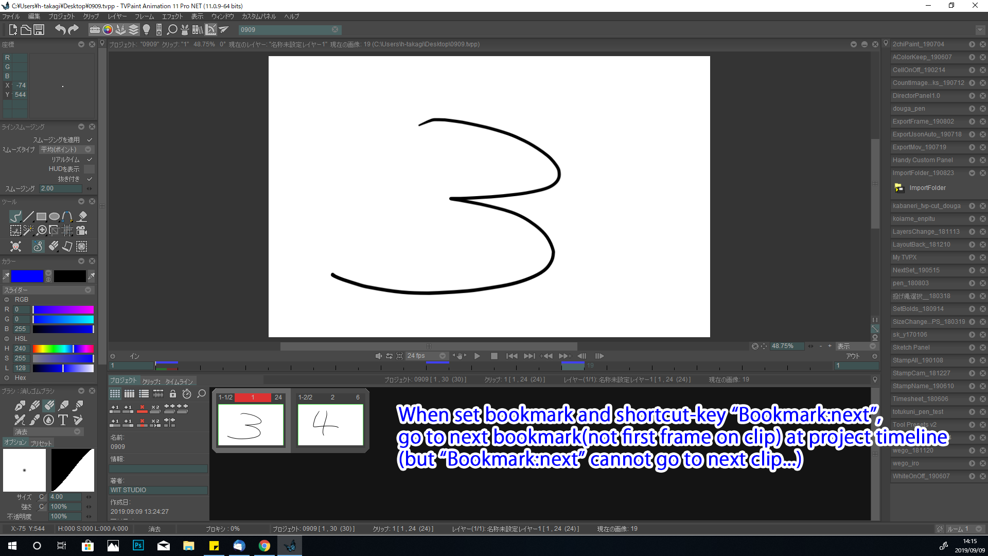

Re: Next Frame -shortcut?
Post by Hironori Takagi »
I think that request by masiyooo is display a frame "not first" in a clip when the "Project" tab is selected.
Although it is not a complete method,
use “Bookmark” the frame that want to display and using “Bookmark: Next” and “Bookmark: Previous” shortcuts.
The problem with this method is that pressing "Bookmark: Next" at the last bookmark can not jumps to the first bookmark of the next clip.
You may submit it as a request for improvement.
