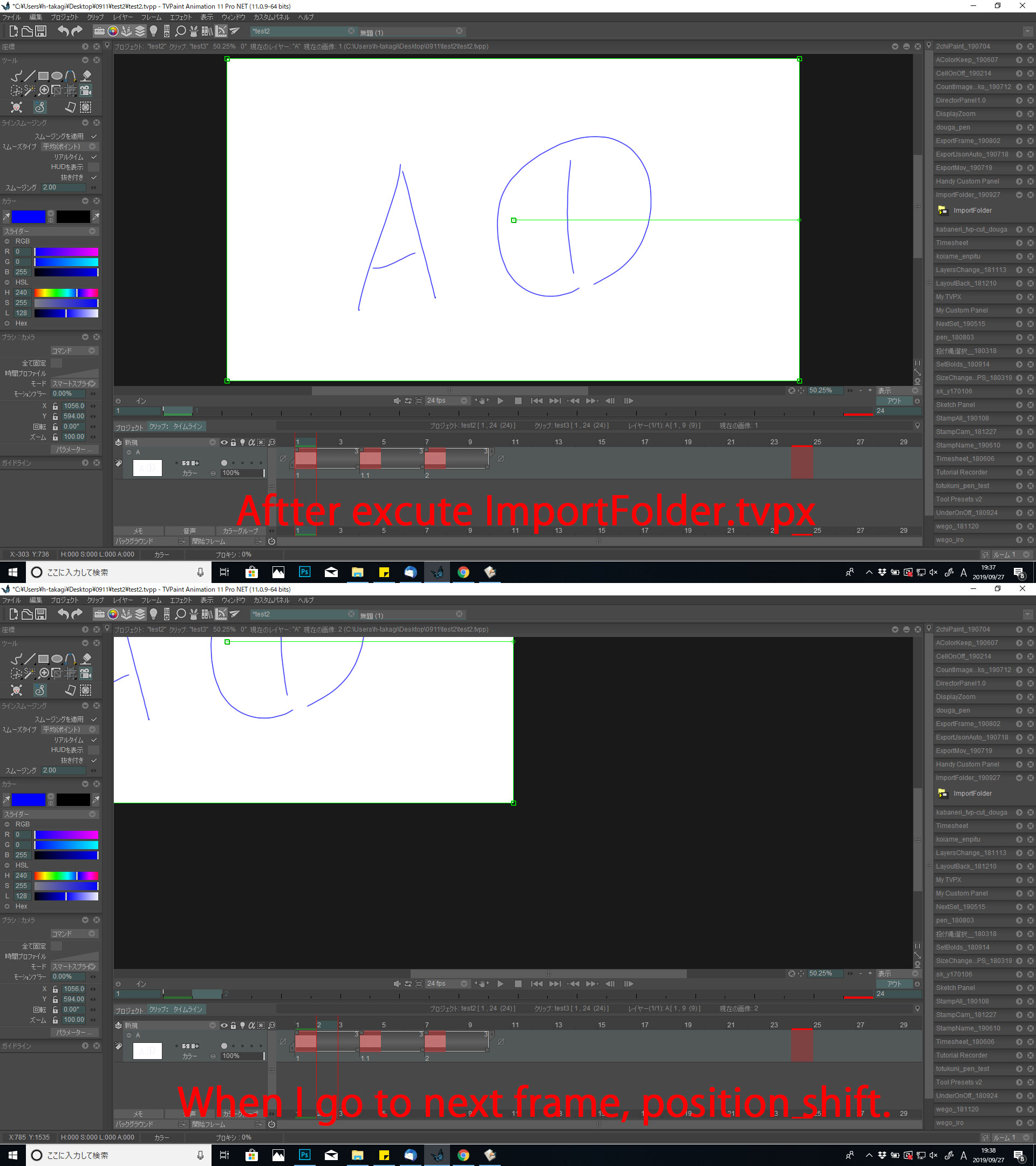

I'm developing an import George script and I have a question about it.
The attached file is a script that reads the sequence image files when one of the file in sub-folder is specified,
but there is a phenomenon that the position is shifted after execution in Windows version 11.0.9. It does not happen in 11.0.8 or Mac version 11.0.9.
Even if tv_menushow "current" "fitdisplay" is executed at the end of the program, this phenomenon will occur. Can't you confirm that this is a bug specific to Windows version 11.0.9?

This problem is self-solved.
It seems to occur when it is a camera tool when running George.
As a workaround, I would like to adopt a method exiting in other tool.

I will not change this topic to resolved. In essence, it is the recognition of malfunctions in TVPaint's camera mode.
This is not a serious bug, but we want you to deal with other issues with priority, so we don't care if we will deal with it.
The resolved code has been published below.
