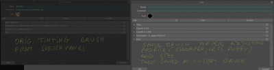

I don't know anything about scripting, but I took a screen grab of the edit menu of a default tinting brush (left) and the saved adjusted brush (right). I can see how they look different, but I have no idea on what to do with that.

Hello Holger, the problem is that the SketchPanel Tint Brushes are not using the normal color to tint instead they use a customMode
"tv_custommode 0 0 0 0 255 0 0 0 0 0 0 0 0 0 0 0 0 0 1 0" -- This function represents the tinting color instead of a normal ColorA or ColorB
If you want your brush to TINT, then the easiest way would be to lock the layer transparency and then paint with your brush, that'll be the closest to the tinting you're looking for with the custom brush.
Also you could remove the COLOR A and COLOR B from your CUSTOMBRUSH and just add a TYPE SCRIPT COMMAND with a fixed color for tinting. In that case would be this command for RED

Thank you! I will try the idea with replacing color a/b with tv_custommode 0 0 0 0 255 0 0 0 0 0 0 0 0 0 0 0 0 0 1 0.
