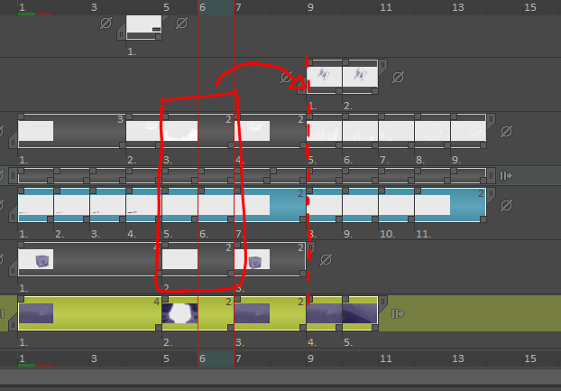

Re: Moving selected instances in multiple layers
I have the same issue. There is no way to move the selected frames on several layers at once?
- Captura.PNG (35.6 KiB) Viewed 7106 times
