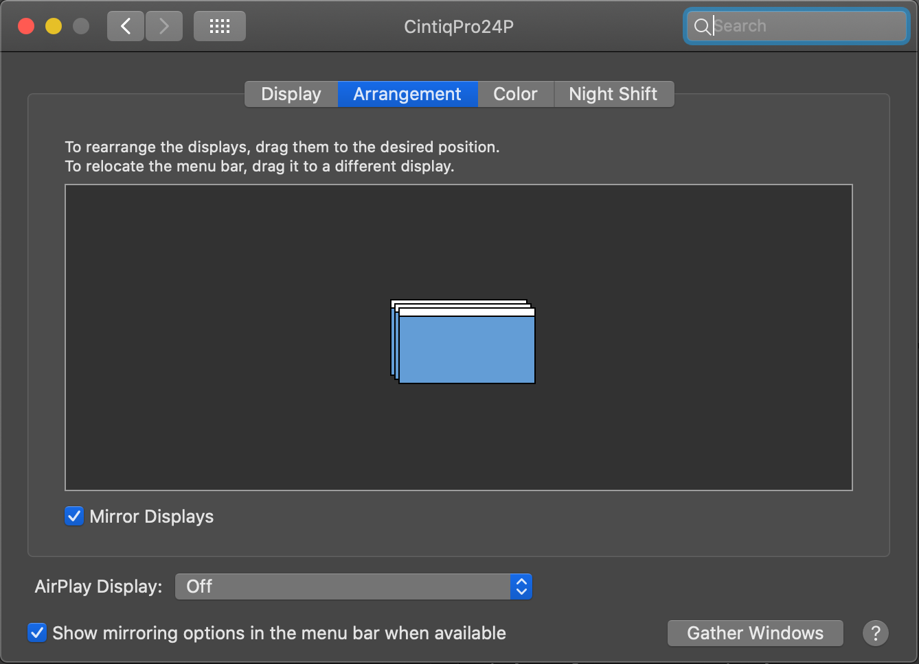

I don't know this helps but I'm sharing what I found out.
I'm using mcbook pro 16" with 32GB memory and the best graphic card choice. I recently found I have an issue with lagging when I draw. It wasn't in high resolution setting and also not special brush.
It was just basic pen brush on 1920x1080 drawing panel.
The thing is that I didn't have lagging issue before but it happened just a month ago suddenly. I thought it's because of recent upgrade of TVPaint but there is no way to download previous version.
I thought maybe it's memory issue so that I raise usage of memory up to 24gb only for TVPaint in preference. but it's still lagging. I was frustrated.
Then I thought it's weird that the lagging issue came from nowhere suddenly even if I didn't change any software or hardware since I bought Mcbook pro in March.
I found one difference. It is multi screen. A month ago, I bought extra high resolution monitor for having enough screen room. Before I purchase monitor, my display setting was mirror mode (every screen is same screen) and I didn't have lagging issue. As soon as I noticed, I turned off the monitor and change display setting into 'mirror mode'. Then boom, no lagging even if how fast I move my brush. I think issue is coming from having multiple screens. Since every screen has different color, resolution limit and setting on its own, computer itself may take more time to calculate things than having just one screen setting. I'm not a computer guy. This is just my thought.
I attach screenshot images. you could have better resolution when you optimize your screen on your Cintiq.
I will use mirror mode when I use TVPaint from now on. I hope everybody solves lagging problem with this.
