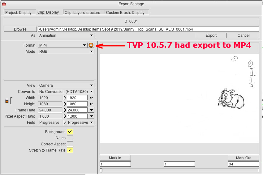

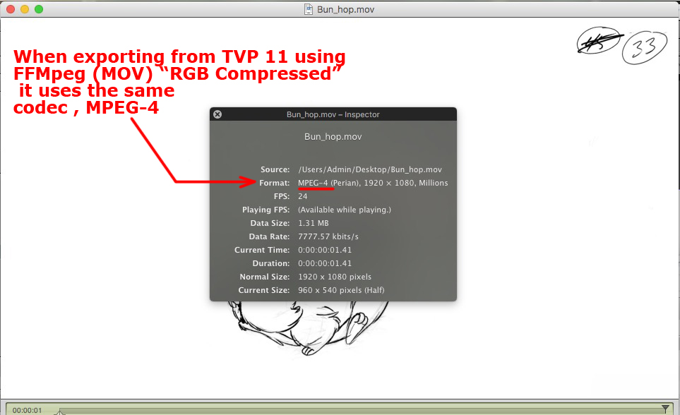

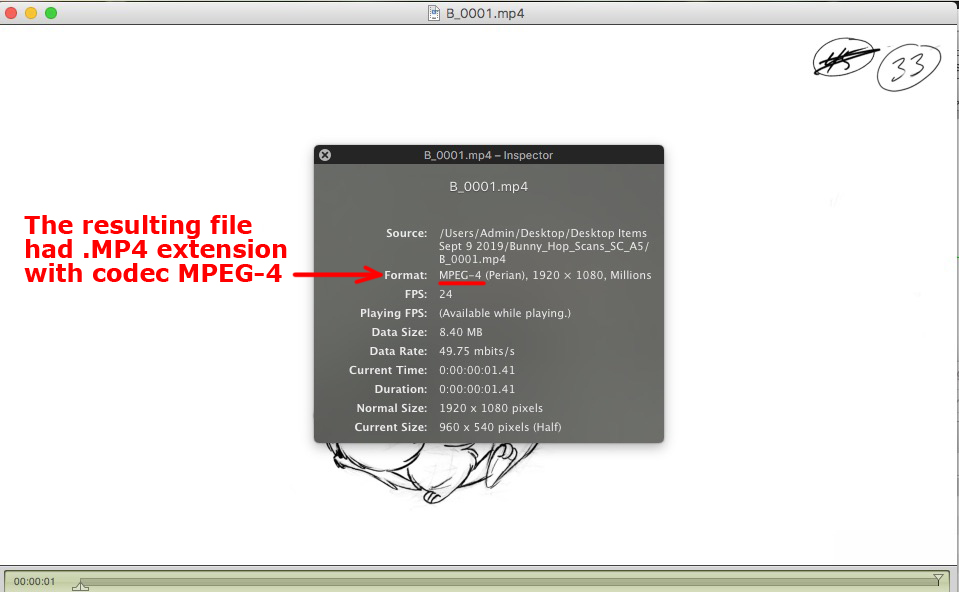

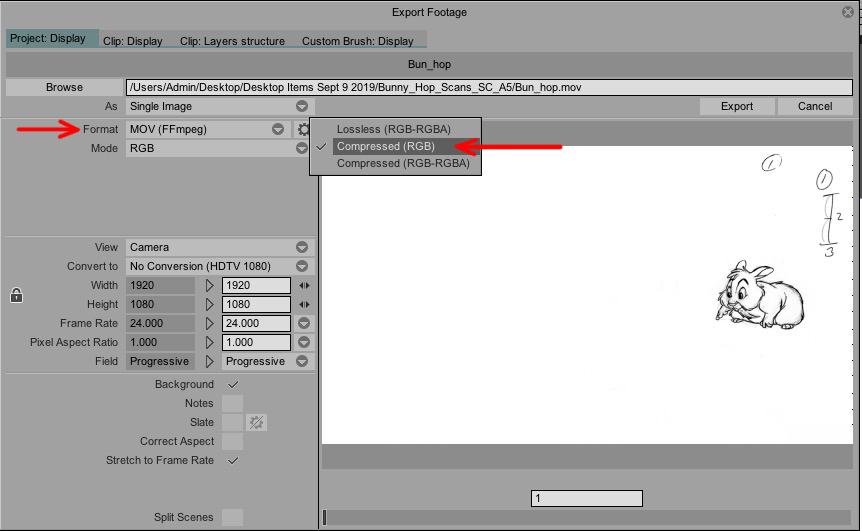

In earlier versions of TVPaint , such as TVPaint 10.5.7 , there was the option to export to .MP4. I don't know why that option went away in TVPaint 11.
Of course you're correct about the distinction between the container and the codec . Although the article does point out :Xavier wrote: ↑20 May 2020, 08:01 Again, I think you confuse the container (mp4, mov, mkv, flv, avi) and the video codec (DivX, Sorenson, H.263, H.264...)
You might want to read this article : https://www.makeuseof.com/tag/all-you-n ... mpression/
Yet it's weird that exporting to mp4 doesn't work now, if it was possible before.

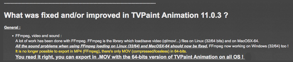

"It is no longer possible to export in MP4 (FFmpeg), there's only MOV (compressed/lossless) in 64-bits."
nice catch !!D.T. Nethery wrote: ↑21 May 2020, 14:11The only mention I can find of it is when the software was updated to version 11.0.3 it was stated:
