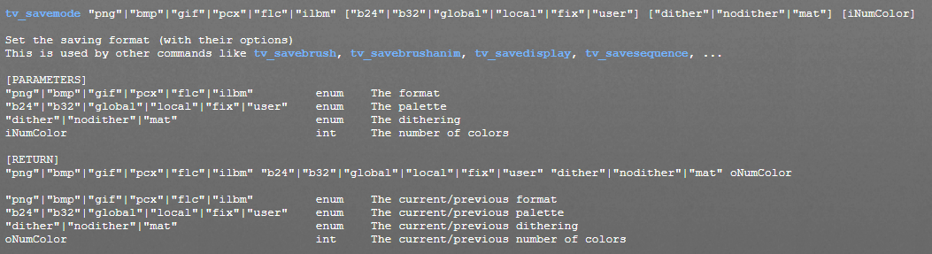

Here are the available options for the png export in George:
As M. Takagi said, it's not possible to use all advanced settings in George (like compression, PreMult or no PreMult)
I also advise you to use tv_SaveMode before calling tv_ClipSaveStructure in your script :)
