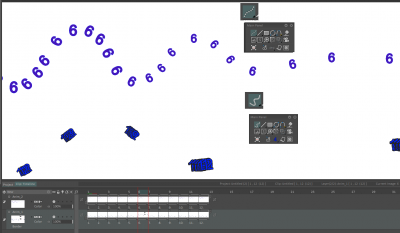

Thats a usefull approach Sven, but to be clear;
The issue of multiple putdowns when drawing with CTRL, can be avoided by simply choosing 'Dot' stroke.
top stroke is Dot
bottom stroke is freehand
top stroke is Dot
