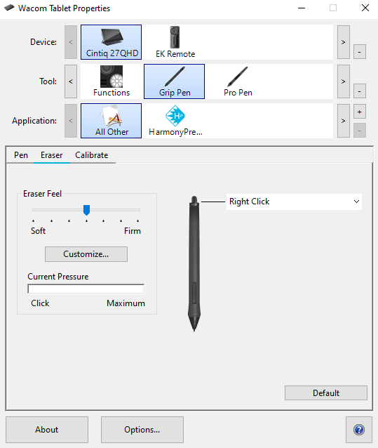

Re: Eraser Issues
solved
you pen-flippers out there....
in the wacom settings set the eraser tip to right-click.

Re: Eraser Issues
Keep it as it is.
It was not a bug.
The desired functionality can simply be achieved by setting up the wacom pen as i described.
It was not a bug.

Re: Eraser Issues
I agree! That works great and is much more efficient.Peter Wassink wrote: ↑16 Oct 2020, 11:46 Keep it as it is.
It was not a bug.
Thanks Peter
