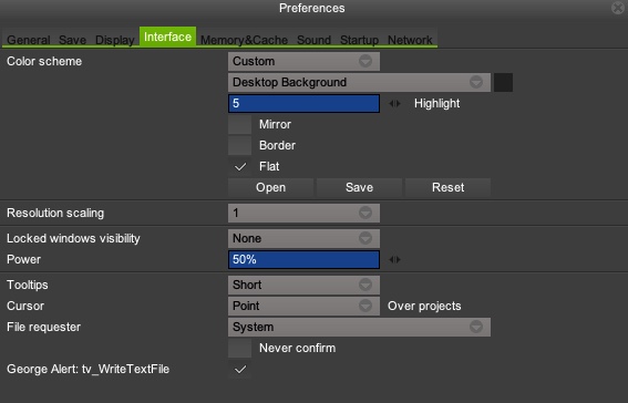

Could you please show us your Preferences->Interface tab ?

Still, could you please show us your Preferences->Interface tab ?

Sure thing.

So, as I thought, you're using the "System" file requester. Which opens a system dialog box to choose where to save your project. So as mentionned by slowtiger, it's most probably a system failure that caused this.
I agree that the TVPaint file requester is not that fancy, but it could be more tolerant to MacOS faults.

Wasn't really aware of this option. So I changed it and now I get this strange looking stripy interface. Kind of PC looking. Are you suggesting it's a more stable way to save? Or should I just change to it if this problem ever happens again? Why is it there? I've not seen such an option in any other application on my Mac.

This one is run by TVPaint, so it may appear when the system dialog can't show. Try it if you face the same issue.. . Lets hope you won't !
