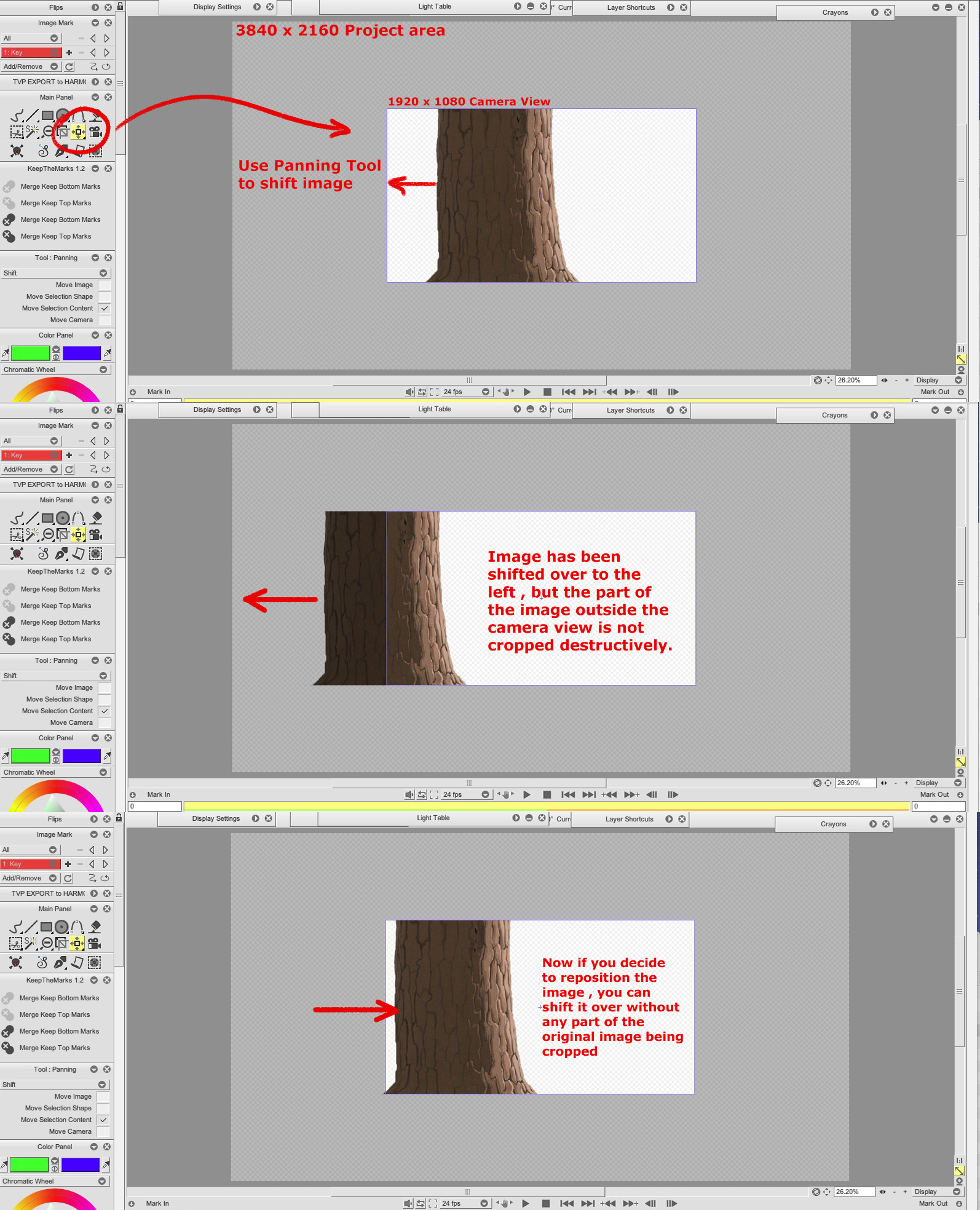

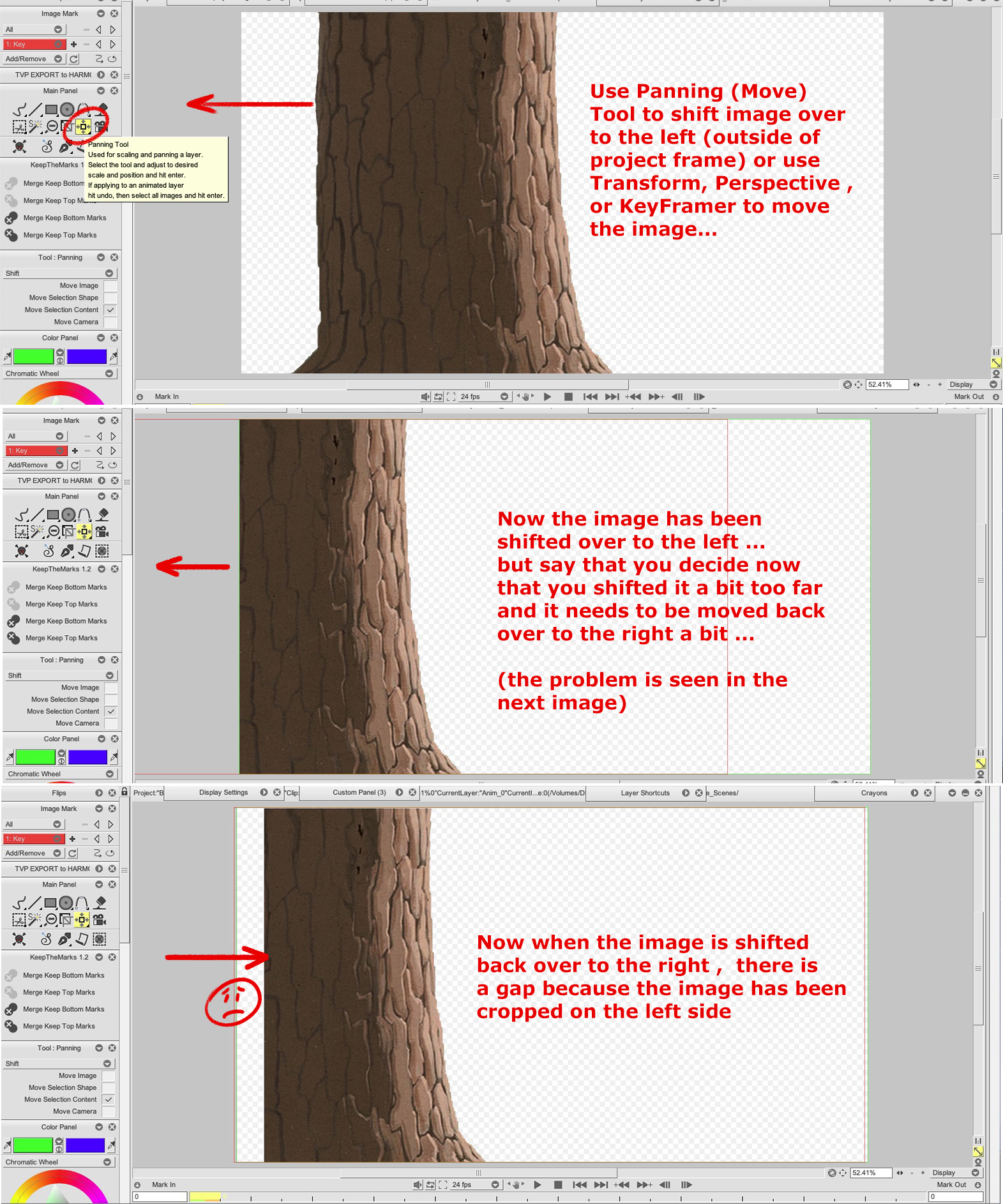

(3-2)Want to solve lost images outside the project size
→Not solved

(22)Importing a image with a size different from the project size results in cropping at the project size
→Same problem at (3-2)
→Not solved
This is an important issue to solve. It baffles Photoshop users transitioning to use TVPaint. Even for those of us accustomed to using TVPaint it can be a bit of a pain. As I understand it , this refers to the problem where images are destructively cropped if a portion of the image is moved outside the project window using the Panning (move) , Transform , Perspective Tools or with KeyFramer FX tool. For example , if this image is shifted over to the left using the Panning/Transform/or Perspective Tool (with part of the image going outside the project window) , then you decide you want to shift it back over to the right slightly , now the image has been cropped destructively and you can't get it back without several steps of CMD Z Undo. (which is sometimes not possible depending on where you are in the process. If you've progressed several steps beyond when you had originally moved or transformed the image , you cannot fix it by CMD Z Undo without also undoing all your other work ...)
(click on images to see larger)
However, I don't think this is solvable in the current engine of TVPaint (?). Can someone from TVPaint Development confirm this ? (in my memory , I think I was told previously -- many years ago -- that this is not possible to fix in the current engine of TVPaint , but I am unable to find a specific reference on the forum) This has been such a long-standing feature/improvement request from many users , if it could have been solved I think that it would have been solved before now. This may not happen until next generation version of TVPaint .
The only workaround for now is to create the Project with Camera View , so the project area is scaled up 200% - 300% , so for example, if the intended output is 1920 x 1080 , the actual project size is 3840 x 2160 , creating a border area surrounding the Camera View (1920 x 1080) , which allows objects to be moved using the Panning/Transform/Perspective Tools or Keyframer FX, yet they can be repositioned again if needed without the original image having been cropped , because that part of the image was simply outside of the Camera View , but has not been moved outside of the project window, so it is not destructively cropped.
Yes, I also mentioned this in a previous discussion about the feature Clipboard > Paste Image . Say you have an image sized at 4096 x 2304 which is copied to the clipboard and then pasted into a TVPaint project sized at 1920 x 1080 , the image pasted from the clipboard will be cropped . However, if importing the larger image using the standard Open/Import window the option is there to import the image to a Layer, which automatically resizes it to fit inside the project window. Because this can already be done when using standard Open/Import , I would think the same behavior could be applied to the Clipboard > Paste Image (New Layer) to allow the pasted clipboard image to be automatically resized to the current project size. (but even better would be to allow for parts of an image that are outside the project window to be preserved (as in Photoshop) , so if you brought in a larger image you could then shift it up-down or side-to-side with the Panning Tool or resize it with the Transform Tool to scale it down to fit inside the project window, without destructive cropping having been applied to the original image)Hironori Takagi wrote: ↑13 Nov 2020, 08:20 (22)Importing a image with a size different from the project size results in cropping at the project size
- Posts: 4517
Re: Summary of past requests on WIT STUDIO
BG elements i sometimes import using the Keyframer to keep it non-destructive
For animation, i circumvent this issue by having my pan tool in "Fill" mode, that way you can always reposition non-destructively.
i use this for instance when re-spacing animation to fine tune arcs.
Only one thing you'll need to do... in the finalizing of the project you have to erase the bits that wrapped around to the other side of the frame.
