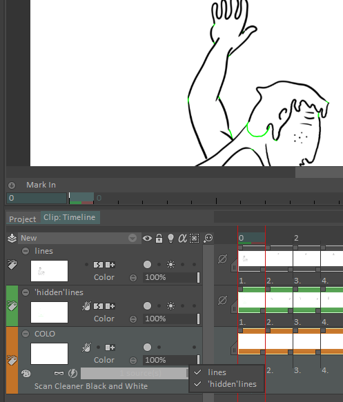

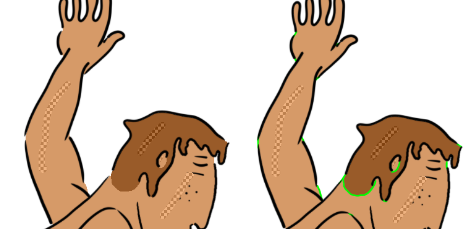

you can create a second 'hidden layer' on which you draw lines to close the gaps.(i would recommend a distinct contrasting color)
you can switch that layer off (hide it)
and then in the C&T layer set both layers as source.
hidden lines c&T.png (56.77 KiB) Viewed 5287 times
hidden lines c&T2.png (36.69 KiB) Viewed 5287 times

Brilliant! Exactly what I wanted to accomplish and a quick/easy fix. Thanks again, Peter.
