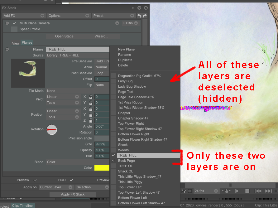

This feature request was added in 11.7.1 ("toggle visibility of layers in the Multiplane Camera") , but there is a persistent issue with this feature which needs to be improved, although the issue may not be the Multiplane toggle visibility of layers specifically, but rather an issue about how Undo is applied to actions taken in the FX Stack.
So, let us say I have a Multiplane Camera project with 25 layers. For ease-of-use, so I can focus on adjustments to only a few layers at a time , I deselect 23 of the layers, with only 2 of the layers still selected and visible. Now a problem occurs: while I am making adjustments on these two visible layers if I UNDO (CMD Z/CTRL Z) it will undo the adjustment I made in that layer's X - Y - Z coordinates, but it will also apply undo to the previous layer selections/deselections in the list of Multiplane layers, so now all of the layers will be selected again and the user must manually deselect each layer again to return to the previous state before clicking Undo. It seems to me that Undo should apply only to the last action the user made in the FX Stack while adjusting the coordinates of the visible planes , but Undo should not apply to the previous action of deselecting the planes , so that the deselected (hidden) planes are now selected again.
The other problem I have noticed with the toggle visibility of layers in the Multiplane Camera is if I SAVE the project with only 1 or 2 planes selected (and all the other planes are deselected) when the project is opened next time all the planes are selected again. It did not save the project in it's last state , with most of the planes deselected. When saving the project , the current state of the Multiplane Camera FX Stack should be saved so when work is resumed at a later time the user may start exactly at the point where they left off work in the previous session.
